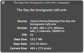

Here's the inspector from Quicktime:

Did you purchase this from the iTunes Store? I thought the iPlayer only had Flash content? Or did you capture it in MPEG-4 h.264 using some program?

It's not your apple TV. What you need to do is get info. (command I) on your movie file and make sure your movie file is set to open with itunes. If it says open with Quicktime switch right away cause that is the problem. I noticed this exact thing happened to me about a month ago with the new version of quicktime. It changes it to protected mpeg-4 and apple TV can't read these files.
It's from iPlayer, hence the DRM is Adobe AIR, not Quicktime, and Apple TV won't play it as it lacks any sort of Flash support.
