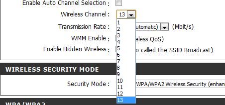

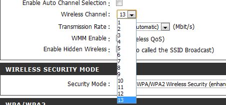

Default channels on most wireless routers are 1, 6 or 11. Usually if you stay away from those you are fine. Some devices don't like the off channels, but most will connect on whatever channel you choose.
Not sure where you came up with the channel 13, but the highest is 11.
Channel 13 seems to be an option in my d-link dir300 and everything seems to work with it fine.
