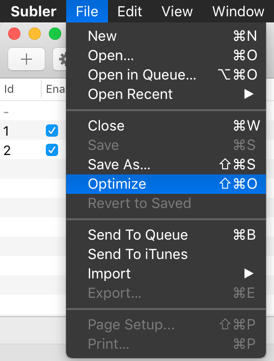

Your video file definitely has a problem.
I have yet to see an aTV-compatible file from HandBrake that won't play or start to play after brief initial buffering.
So you must have broken it with Subler while adding tracks.
To begin with, try a simple thing - take the Optimize command (Shift+Cmd+O) from Subler File menu.
This will rearrange the MP4 structures so that headers are at the beginning of file and received ahead of media content - so playback can start without seeking until end of file.

Thanks so much, that did it. Does the optimize command degrade quality at all?
I am guessing I should do it all the time I add chapters and tracks?
No, it won't do any change to content of the tracks (ie media or metadata).
It will just bring the vital data containig info about file content to the beginnig, so it is received early on.
I have seen such problems when adding audio tracks. Not so with chapter tracks.
