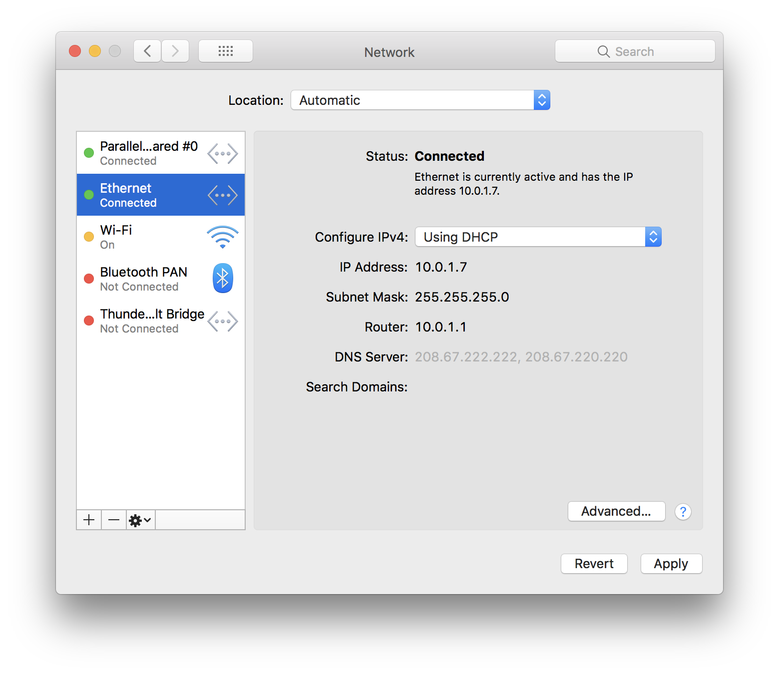

Is your MacMini using DHCP or are you using a static IP address? I'm wondering if when you reboot with a new DHCP address that causes the problem because the Apple TV is using the old address.
I just changed my Network settings to DHCD with manual address to see if that makes a difference.

To repeat what I said earlier, is the MacMini getting its IP address via DHCP? On your MacMini open settings, network, and select your adapter (likely Ethernet, with the word "connected" underneath). If "Configure IPv4" is set to "Using DHCP " try changing it to "Using DHCP with manual address", specifying an IP address on your network that isn't being used by any other device.
When your Mini reboots using DHCP it may get a different IP address. If your Apple TV tries to connect using that old address, it isn't going to work. If the address doesn't change between MacMini boots then maybe it will fix the problem. Don't really know, but worth the try.
