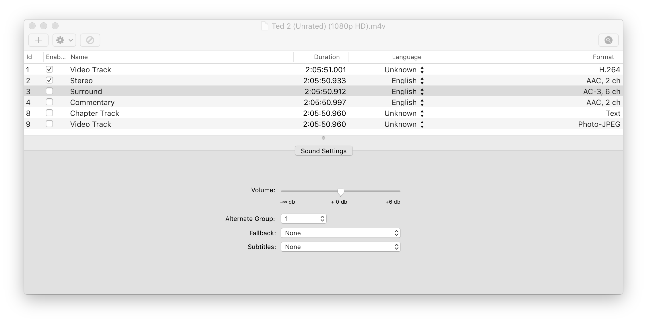

This happened because handbrake does not set up fallback track for DD track. You have to use Subler for that. If these tracks are separate, you'll see two audio tracks on ATV. If the fallback track is set, there's only one track and ATV selects correct one based on your settings. Files encoded this way worked ok on previous version.
I just did the encode with HB, and have not set the fallback track, but the behaviour is now the same as it was with aTV 3 (Surround track is selected by default, even in Output = Auto setting).

Yes it works now. But I recommend setting the fallback track to avoid problems in the future.
