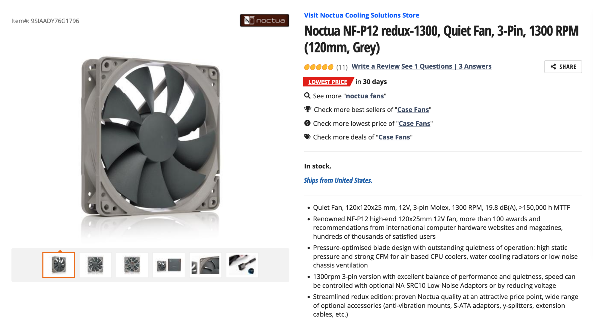

The original Sensflow in my PowerMac G3 definitely seemed to ramp up with usage, but I can't confirm how much air it was moving. Looking at the blades, though, it would appear as though it can put out more static pressure than the Arctic fan can. I wonder if instead I should have purchased a high-pressure fan meant for this application.

For laughs, it would be interesting to take the original Sensflow fan and use one of the adapters to run it at 7 volts and see what the acoustics are like.
Because the original Sensflow is using a PTC-Resistor im nearly sure the fan ist not starting with a 7-Volt-Adapter and a room temperatur of around 20°C.
