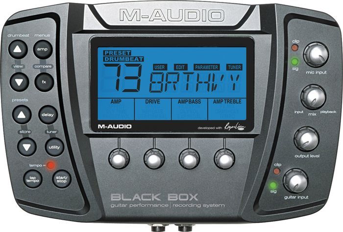

I also came across this M-Audio Black Box Performance/Recording Sysytem. Apparently it is a guitar fx box with drum machine and preamp/audio interface. It's USB but because all of the effects processing happens outside of the computer, there is almost no latency. It comes bundled with Abelton Live Lite.http://digitalmedia.oreilly.com/2006/05/17/review-m-audio-black-box-v2.html
any comments?
