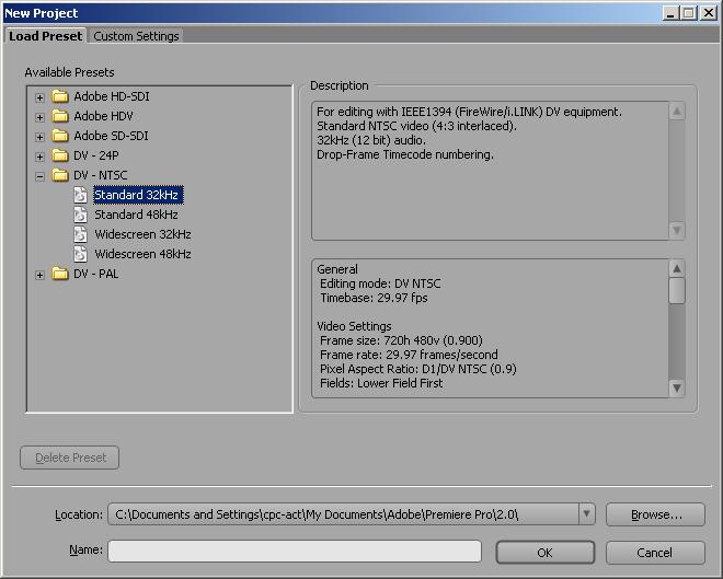

I think Pat H is referring to the difference between the DV audio formats. DV supports two kinds of audio: 12-bit 32kHz 4-track audio, and 16-bit 48kHz 2-track audio. I have edited both in Premiere CS3 without any problem. You just need to make sure you are using the right preset (32kHz for 12-bit, or 48kHz for 16-bit) when you capture. The option is definitely there, you just have to look for it.
Look at this "New Project" screenshot from Premiere and you should see the 32kHz/48kHz preset options. Notice under "Description" where it says 32kHz 12-bit or 48kHz 16-bit depending on which preset you select.
Hope this helps.
Edit: I just re-read your post and I guess you are using FCP, not Premiere? It should be same though.
Hope this helps.
