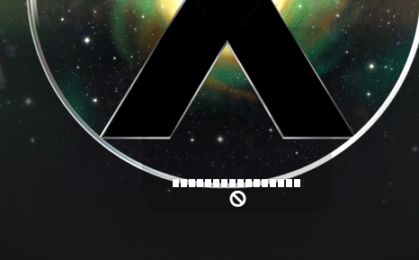

it seems that my computer is not recognizing the speakers/audio out device. when i have headphones in the sound works fine. when i dont and i go to change the volume, i get this

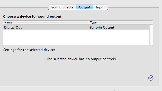

then when i look in the sound tab of system preferences, i see this
its as if there is no output device

It's showing up as if you have an optical audio cable plugged in; that's what "Digital out" means, and that would explain why you can't adjust the volume--when you're outputting a digital audio signal, the volume is only adjusted at the amplifier since it's "raw" data going out of the Mac.

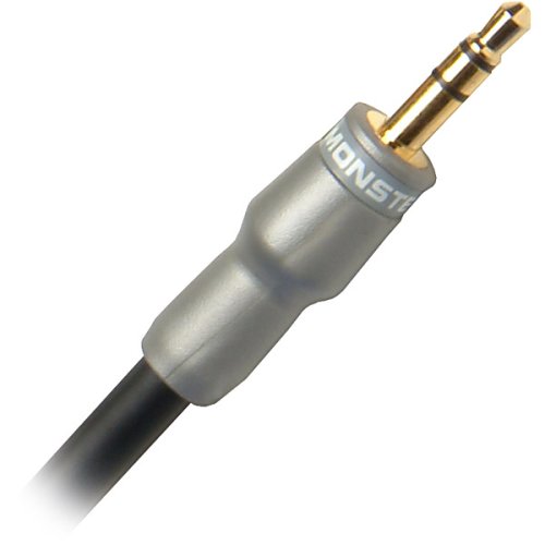

If you're attaching a regular (non-optical) speaker amplifier, maybe it has a funky miniplug that the Mac is reading as if it's one of the mini-toslink optical ones--I expect that would cause the behavior you're seeing.
If you suspect that might be the case, maybe try getting an extension cable from RadioShack or the like to add in, so that you've got a different plug going into the Mac. If that fixes it, that explains the problem you're seeing with both computers.
[Edit: For reference, here's a picture of a regular 1/8" miniplug and a mini-toslink one.]
