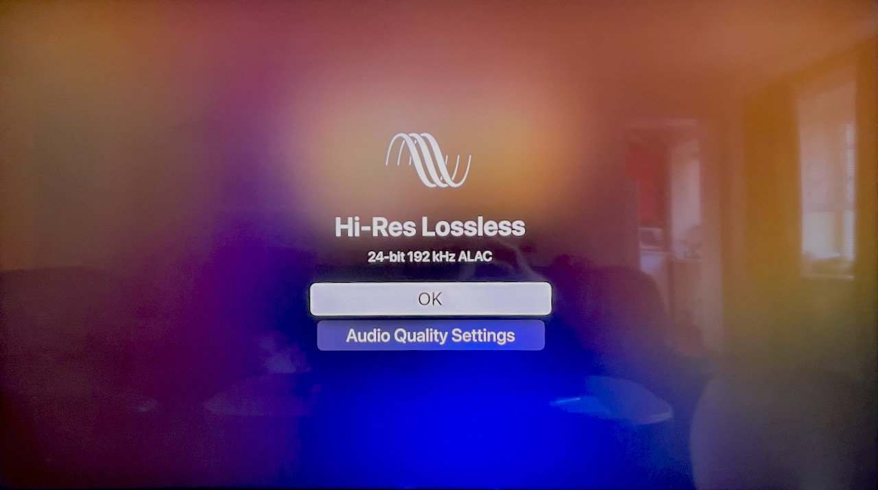

Today, I managed to create a picture like this on my appleTV.
Despite several retries, I have had no luck re-creating it.
What I did - I started playback on iPhone Music app, Hi-Res Lossless and then directed it to AirPlay to my fully turned off HT system. So the aTV woke up, turned on the TV and AVR and showed me this Hi-Res mode on aTV screen.
So it's using the "send a file location" method of airplay, instead of "play on phone and send an audio stream".
not surprising, most if not all of apple's services use this method.
