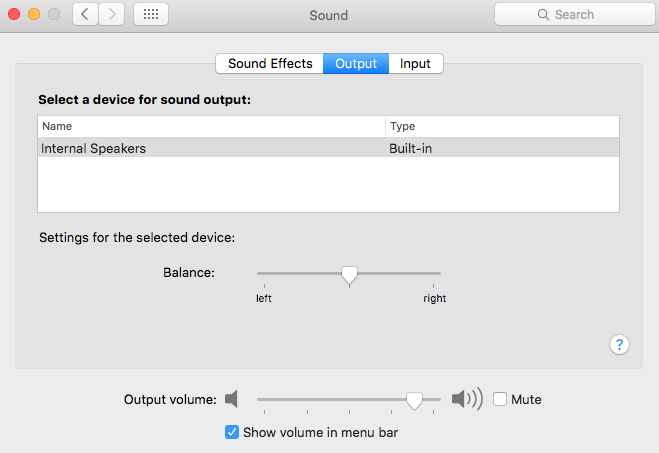

My headphone port stopped working. I cannot select it in the preference window and after some searching on the web and this forum I do not have the red light issue. Most importantly when connecting my headphones nothing happens. I only have one device for sound output to select and that is my internal speakers. What can I do to check if it is a hardware or software? Maybe drivers? I had Airparrot 2 installed and it was a pain to remove (Only app I would assume interferes with audio drivers). This is happenning on an early 2011 Macbook Pro 15"

Hardware failure? If so, then there's nothing you can do about it (short of replacing the logic board).
OP wrote:
"What can I do to check if it is a hardware or software? Maybe drivers? I had Airparrot 2 installed and it was a pain to remove (Only app I would assume interferes with audio drivers). This is happenning on an early 2011 Macbook Pro 15""
Suggestion:
Try booting from an external drive with a "basic" OS installed onto it.
This will eliminate "software issues" and driver conflicts.
Does that change anything?
Does the headphone port suddenly start working again?
If the answer is "no"...
... at that point you may have to think "hardware".
Short of replacing the logic board, I'd consider a small USB audio "dongle" that has in/out ports for headphone, etc.
These are relatively cheap and will give you a workable solution, even if it means having a small dongle plugged in for sound...
