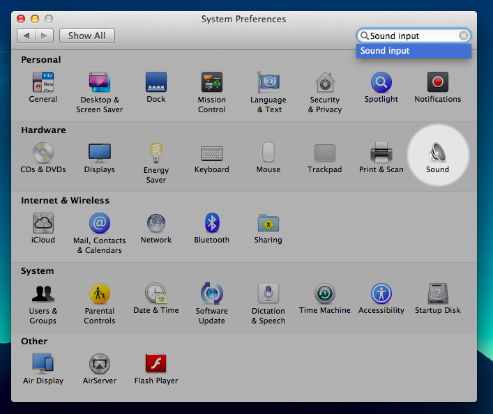

You have to go to this prefrence pane in the System Prefrences: Sound

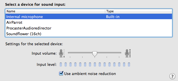

My thinking is that you have Procaster's software as your main input right now. It should look like this. (I have a macbook air, so Line in doesn't apear on my list. But it will in yours.)
Double click "line in" like so it's highlighted like internal microphone is for me.
I think that should help you. Alternitively, if you're using garageband to record from your external source, you can selcet your recording input from Garageband>Prefrences>Audio/midi from this drop down menu.

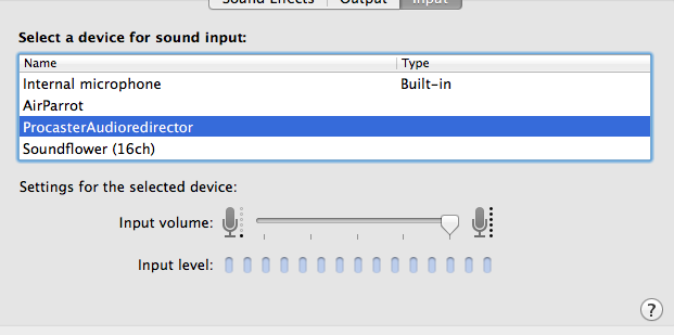

Here's what I see:
Line In is just not there.
