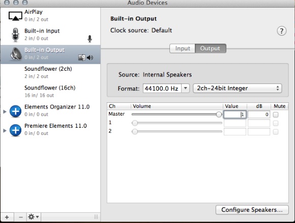

I get a very low audio coming from the Mac Mini via internet without added speakers, and the Audio Out will not come through my speaker. I've made sure the speakers (2 types) work on an old G4 mac.
When I plug in either of the external speakers, the only sound I get is (VERY LOW). I can get a tiny bit of sound from the 2nd speaker the one that doesn't have the on and off switches.
Everything comes back to a audio out problem.
I've read and follow many ideas on the web, i.e., system presences = sound, even went into the Utility>Audio Mini setup, nothing there.

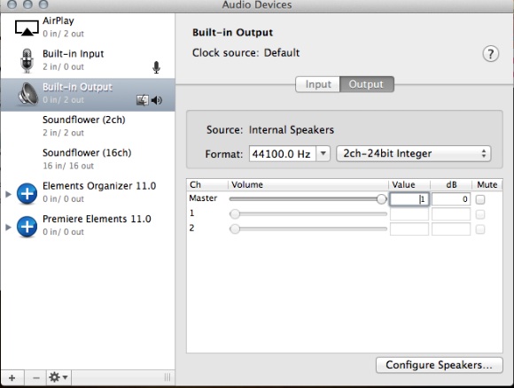

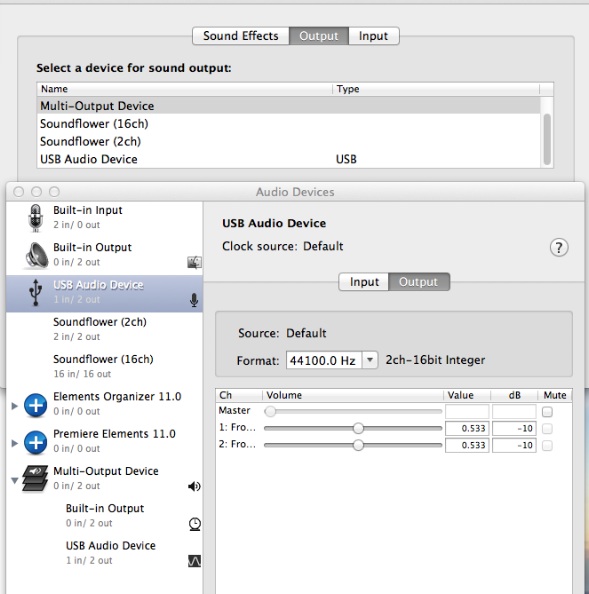

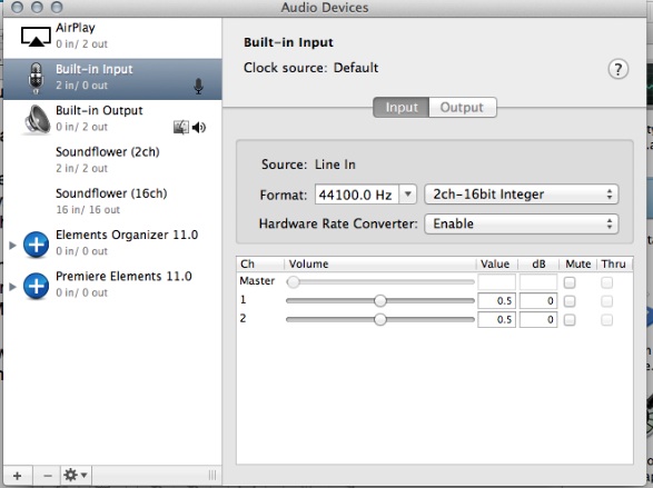

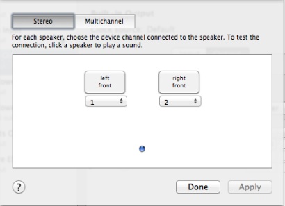

Below are three photos to show what I get from the Audio Devices (utility).

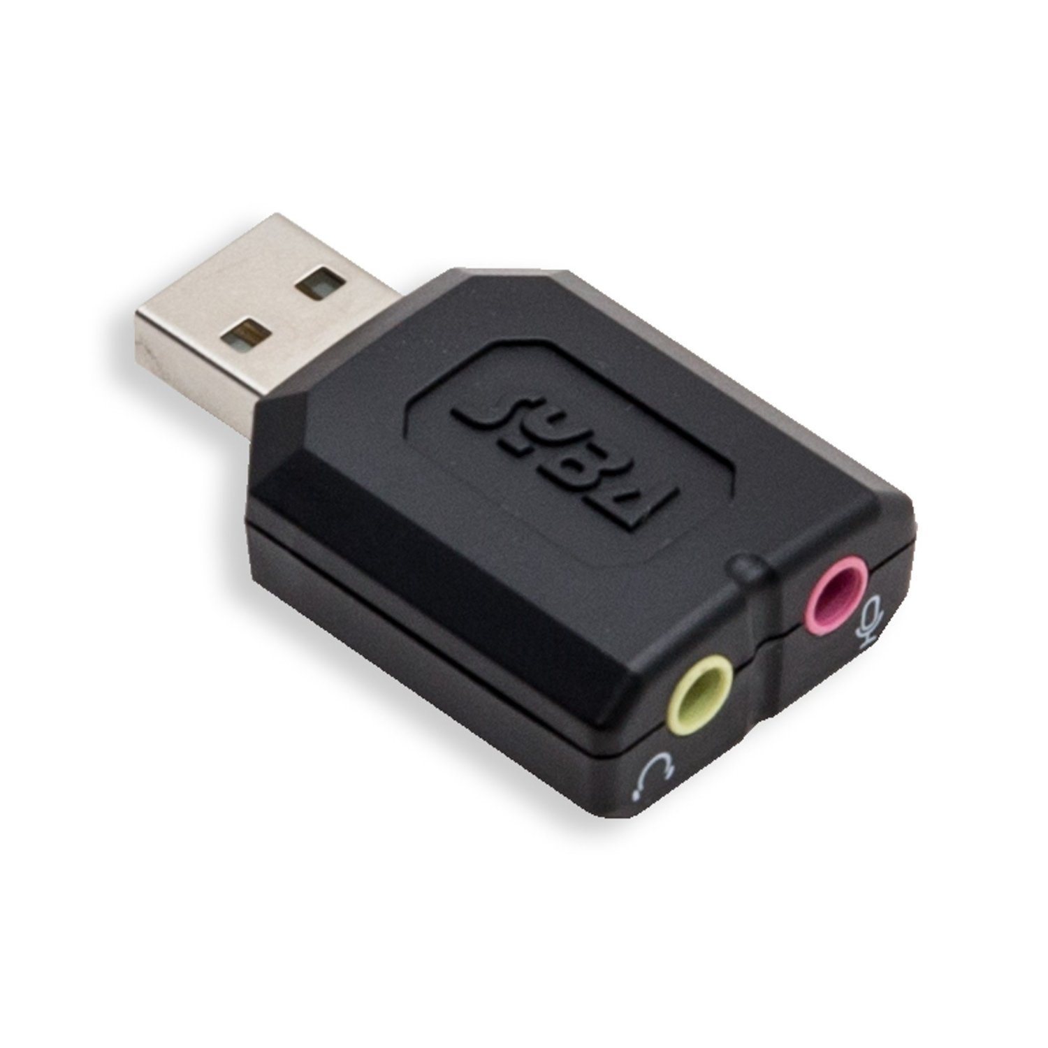

I've had the audio go out on two different Minis myself; but rather than mess around trying to fix the internal guts of the machine, I've just gone ahead and started using USB sound adapters when that happens. Something like this:
They're cheap, and work fine for most standard audio needs. And I can easily use them on other machines if I ever need to do so...

It's been so long since I first posted my problem, mostly my fault, but I did get the USB sound adapter ordered. Now I have 2 of them under the name of TROND (only ordered 1).
I plugged in the USB end using the body of the mini not an extension. Nothing happens. I can hear the music playing when there is no plug used from the external speakers. The speaker it's self works fine when plugged into my old G4 Tower. As far as the USB sound adapter goes, perhaps I just don't know how to make it work.
Many people have problems, but they can't get any sound from thier Mac Mini. I noticed that the Sound Preference has an option I don't remember, "Multi-Output Device. I've played around with Audio Devices from Utilities, but really don't have a clue what I am doing.

I've got one of the Sabrent ones. It's plugged into a USB hub, not directly into the Mini, and I've had no problems with that. In order to use it, though, I did have to select it in the "Output" pane of the "Sound" preferences panel. (The name it goes under is "C_Media USB Headphone Set", and its type is "USB". Hopefully, the Trond will at least have the same type.)
The Mini remembers which audio device I prefer, so I've only had to set it once. 😉

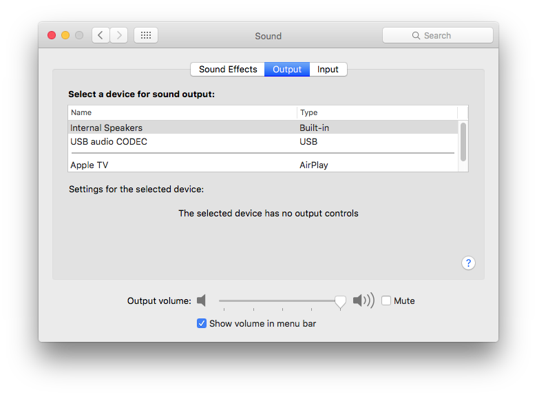

Maybe I missed it, but I didn't see your sound preferences volume setting:
Also what program is producing the sound that you want to hear? What is it's volume settings?
