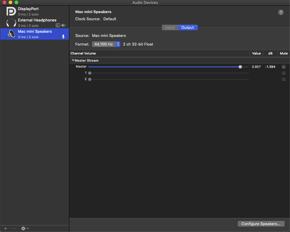

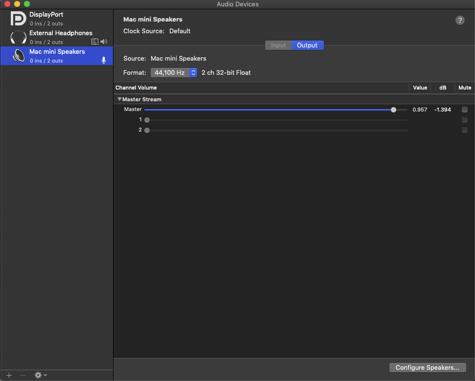

Re your volume problem...
As you may know, there is an app on your mini called Audio MIDI Devices. It's shown in the photo below. Have you connected your speakers and checked the level, in Audio MIDI Devices, for Channel Volume > Master Stream > Master?
If the level is fairly close to 1, you should be getting perfectly good volume from your M-Audio speakers, tweaked by using the volume control on the speakers themselves. The thing is, you don't want Master to be too close to 1, because if you do that you may well cause distortion if you also use your speakers' volume control to increase the volume.
As you can see in the photo, Apple has Master for the mini's internal speakers set at 0.957, or -1.394dB below the point where the speakers will clip. They will clip when Master's value is 1 and dB's value is 0.0.

F-Train, mine is currently set to .7. Should I raise it? .957?
If you are talking about the mini's speakers, yes I'd raise it. 0.7 is about -10dB. There's no reason for Master to be that low. There's also no magic in 0.957. I'd suggest that you raise the level so that you're at -1.0 to -1.5dB.
As a matter of curiosity, did your mini come with that setting? If so, it suggests that the setting varies between machines.
Reactions: ElectronGuru
Yes, that is how it came from the factory. And it is the Mac Mini Speakers. I assume that means the headphone jack and not the internet speaker?

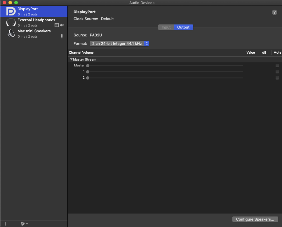

I actually use the speakers in my monitor so it shows another tab called DisplayPort. But none of those sliders are available to change. The monitor speakers are horrible so I will be buying a better set of computer speakers and was curious what level to set it to.
Yes, the level you are seeing is for the mini's internal speakers.
Like you, my monitor has speakers and the monitor has its own volume control. I don't have access to Audio MIDI Devices > Master (see photo below) and the mini's sound volume slider is greyed out for the monitor.
Interesting that different minis come from the factory with different Master/dB values for the internal speakers.

Oh, ok. So when I get speakers and plug them into the headphone jack, that tab will appear. Makes sense now.
Now that I look again, the Mac Mini Speakers setting is .71 which comes to exactly -10.0 dB.

Yes, when you plug in speakers, there will be a new tab for them, just as there is in the photos for the headphones that I have connected to the jack at the moment.
There is no reason at all for the internal speakers to be at -10dB, although it only matters if you use them. To my ears, they sound pretty awful 🙂
