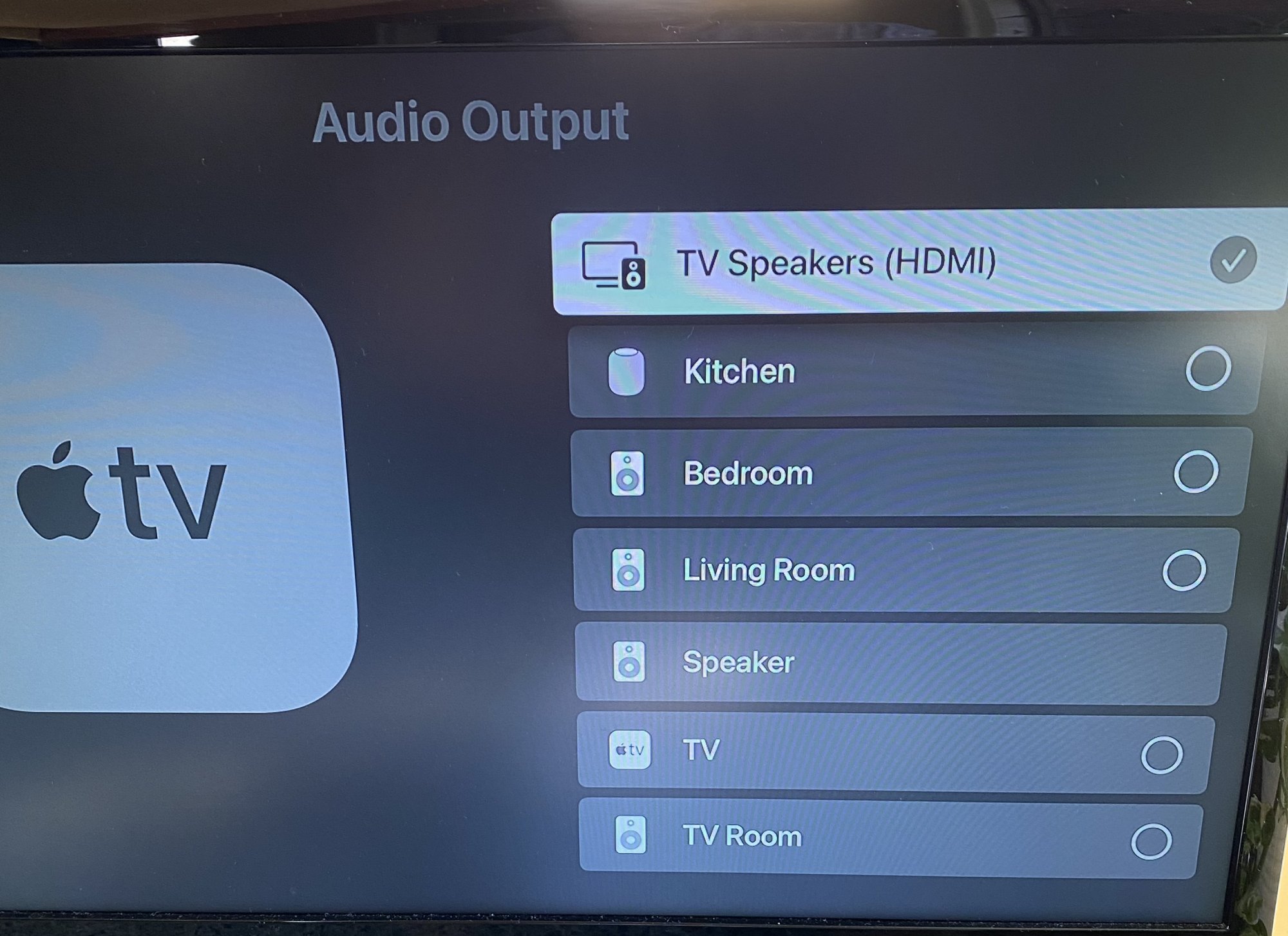

This is not a new feature. Again, I’m not talking about HomePods. The option to select different speakers under Audio Output is available on my Apple TV on 14.0
Thanks for the picture. That looks like the AirPlay 2 interface. In 14.2, default output is not done through an AirPlay 2 interface. Either Apple restricts default output to HomePods, as you suggest, or there is a technical reason--perhaps this:
I noticed that on 14.0 the menu option is called Audio Output, it lists all my available and compatible airplay speakers; on 14.2 the option is called Default Audio Output but it only lists HomePods in the same room where the Apple TV is locate (not sure why the HomePod must be on the same room as the Apple TV).
On 14.2 the option to select an airplay speaker is somewhat hidden under Airplay.
I've been testing and it seems that after turning on the Apple TV, it remembers the last airplay speaker selected; audio went back to TV speakers only in one test of 4 tests I did.
