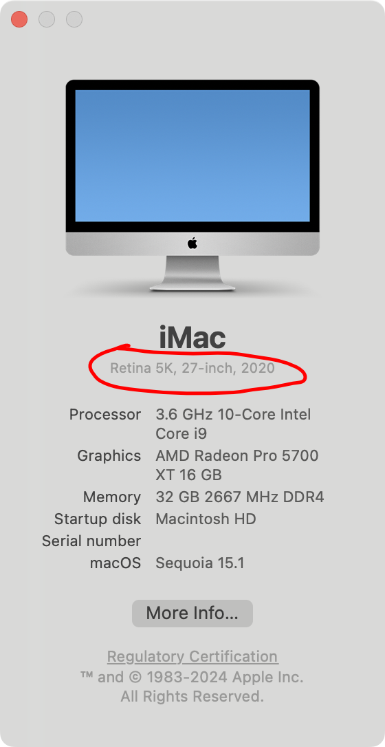

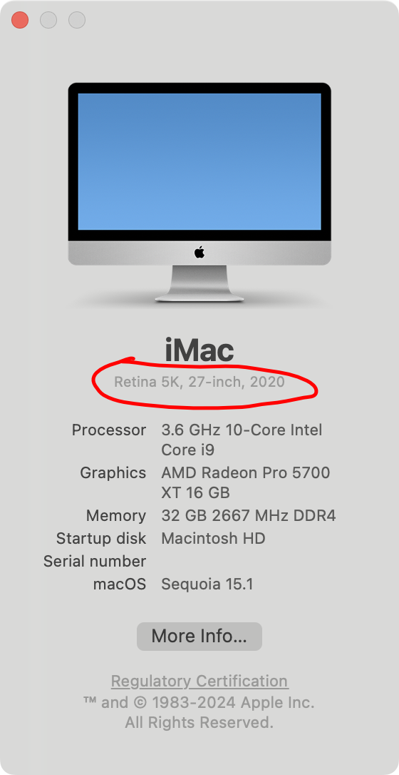

Even easier: Apple menu (top left corner of the desktop), About This Mac.
