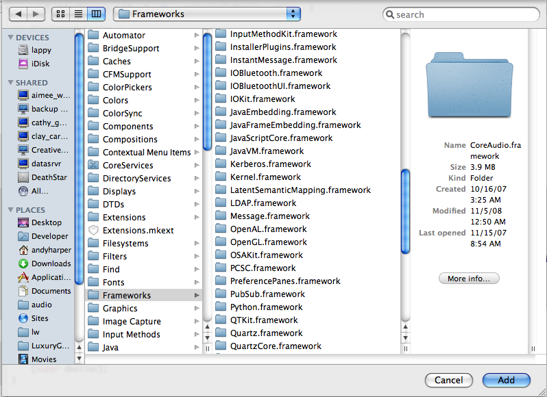

Almost there huh! Man - I can't import the MoviePlayer Framework cause it isn't there! ? Not sure what's going on with that. I d/l'd and installed all of this within the last 7 days. Attached is a screen shot of what see in that dialog...

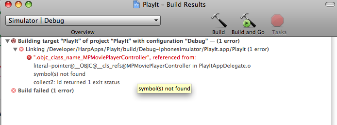

...I located the media player framework, still no MPMoviePlayer framework.
Attached screen shot of the current, single error:

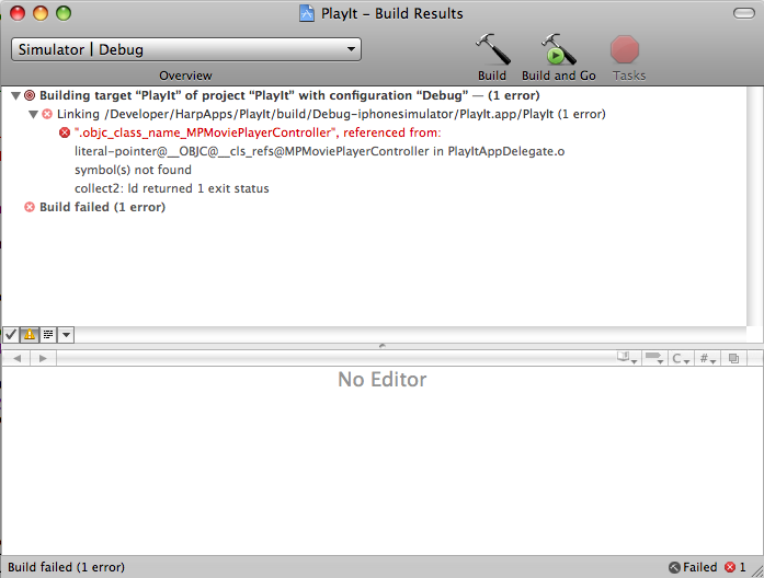

OP, you're missing the star in MoviePlayer *moviePlayer.
I added the star...though I don't see the exact line you speak of.
Current Code:
Code:
NSString *url = @"http://www.limitedwave.com/mp3/FailingForward.mp3";
	MPMoviePlayerController *moviePlayer = [[MPMoviePlayerController alloc] initWithContentURL:[NSURL URLWithString:url]];
	[moviePlayer play];
...gives me the attached error(image).
