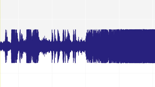

You have Audacity, so you can check the audio to see if fixing it's hopeless or not. Bring up the audio in Audacity and inspect the waveform.
If the bad parts are flat (=horizontal) at the peak, then that's hard clipping and there's nothing practical for you to do (except hire wonderspark).
I've attached an image of clipping, so you can see what it looks like. There are no more bits left to use. Decreasing the level can't remove the distortion.
