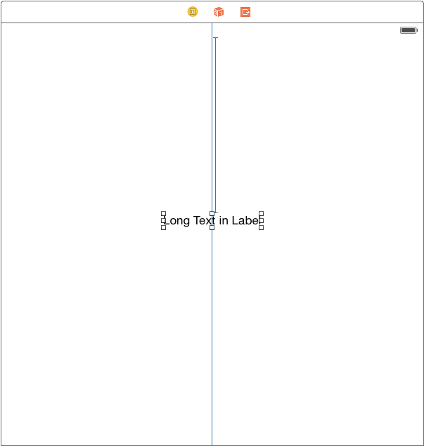

Let's focus on one view in your scene. The text at the bottom I assume is a UILabel and you want it to be at a certain vertical position in the scene and centered horizontally. To implement this you add a Center X in superview constraint to that view and another constraint that sets the vertical position, which will either be relative to the top layout guide or one of the views above it. If you do that this view will be centered on all devices.

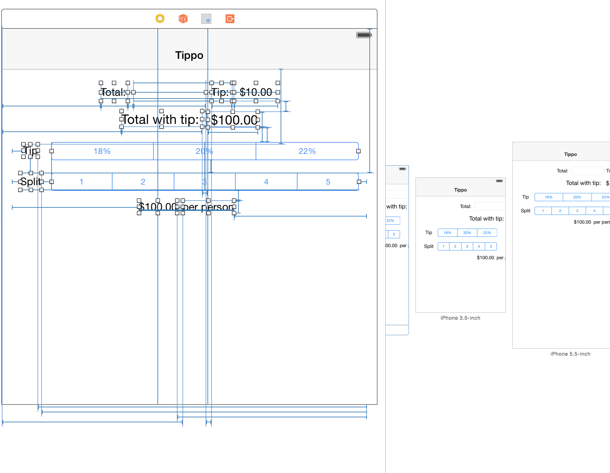

I read Wenderlich's webpage, and it definitely helped me to understand concepts. I'm still struggling though. At one point he says that more intricate projects are going to be more messy to deal with... I may have the messy project with labels and such. His project with squares/ and few labels seemed to auto configure itself.
I've attached another screenshot of where I am at. Any more thoughts? I was a bit confused by your advice.

Do you see any errors in the console when running this. If there are constraints that are conflicting you get some error messages. Also in the design view in Xcode you'll see yellow or red dots if there's an error.
The bottom label doesn't seem like it has a center X constraint. I think the center X constraints are the ones that go top to bottom. Below is what I get for a simple label with center X constraint and a fixed vertical constraint. Notice it has no leading or trailing constraint.
What you're getting I think are views that are fixed to the left side. I think you need to set them so the leading and trailing adjust or the views are simply centered. Are your blue views with the numbers images or standard views?

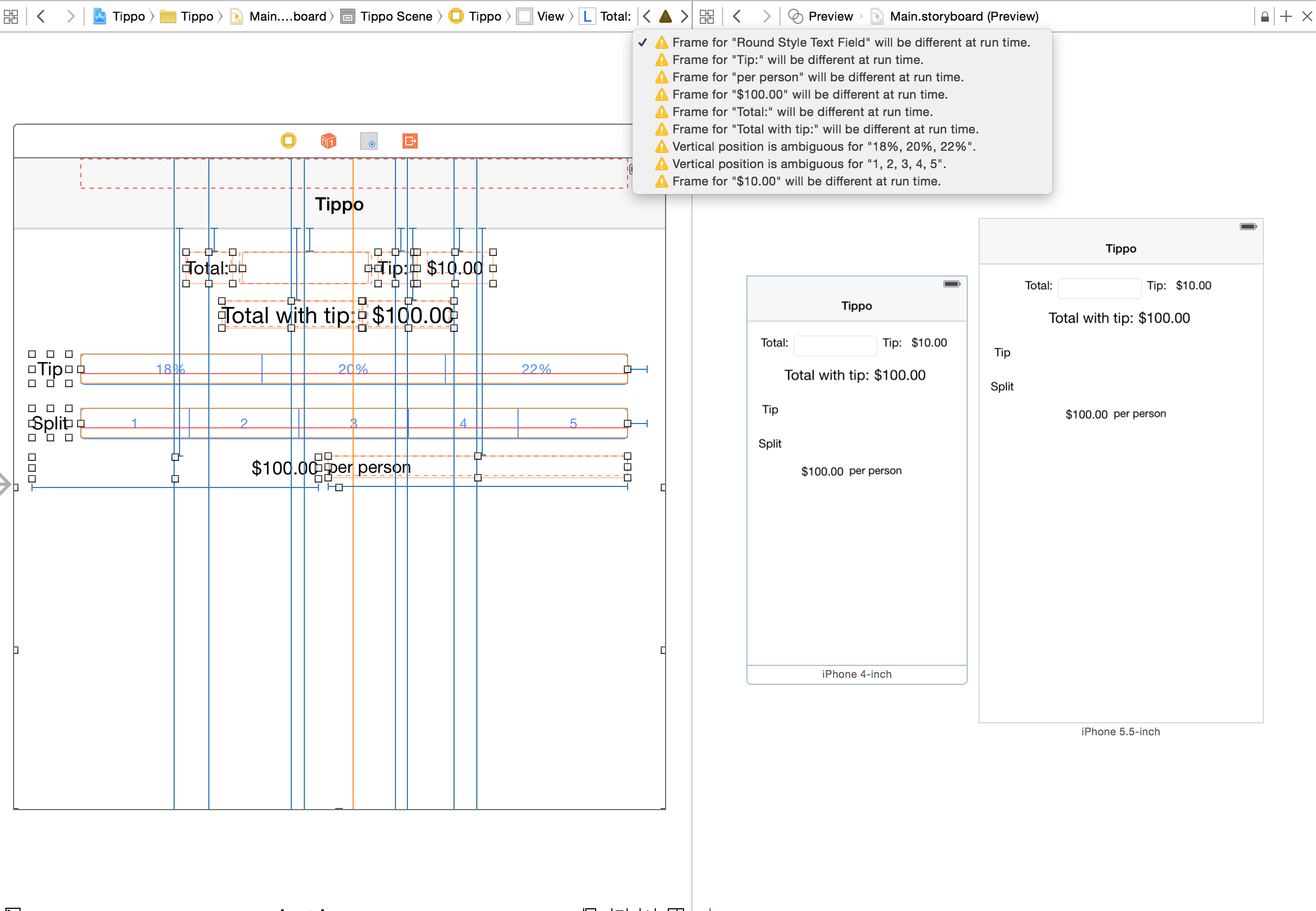

I do have one more concern. I have ambiguities currently (orange lines). The views show up and appear to be working close to what I desire.
My biggest concern...
- Segmented controller is not showing up in the preview to the right. It does appear during Building.
-Ambiguities a concern?

Glad you're getting there.
Yes, you need to fix the warnings. Usually you can understand them. The fix frame, or sometimes fix constraints, menu items usually fix these things. Sometimes you have extra constraints that need to be removed. Anyway, they need to be fixed.
