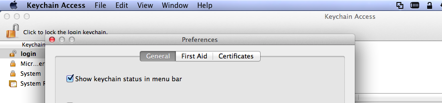

Do this.
Use Spotlight to pull up "Keychain Access". Go to Preferences, and select "Show Keychain status in menu bar".
Then click on the lock in the menu bar and select "Lock Screen". That will start whatever screensaver you have selected. Works with remote or local. I use it everyday on my headless 09 mac mini server and my 2010 Macbook.
See the attached image.
EDIT: Read the OP again... this might not help but, it's quick and easy.
EDIT again: Are you the only one that should access it remotely? Set the option so only you have screenshare access. (Second SS.)

I already added the keychain lock icon to the toolbar. I also disabled spotlight (wonder if that has anything to do with it). I'm looking for a way to lock my server in the event I forget to. Guess I will do some more poking around to see what's keeping it from activating the screensaver.
