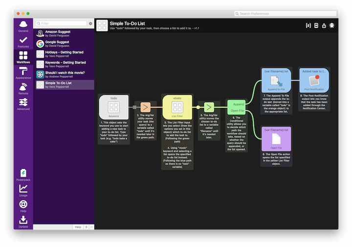

      • slick scripting GUI, similar to Keyboard Maestro and Alfred Workflows, which I really like
