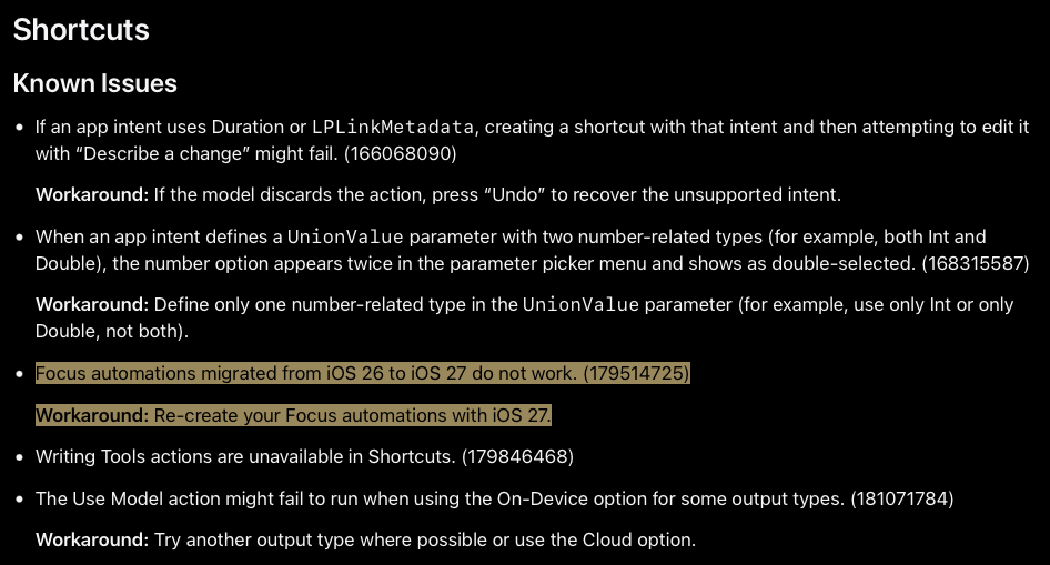

A couple of issues:
  1. Automations that are time sensitive. Example turn off low power battery mode when sun rises not working. However it works for sunset (turning on low power mode)
  2. Time sensitive: changing watch faces at a specific time of day. All the times have moved forward by a hour. Time settings where checked for time zone...
Not sure when editing an automation whether it is saved or not. Only seems to work when using the window "describe a change" at the bottom of the screen.
These bugs have existed in the developer betas too.
Also, if you have any focus automations, they will need to be recreated. This is a known issue published by Apple.
Reactions: targa88 and NoBoMac
Good to know. Hopefully fixed in the next two-ish months.
And will add my tip: if one is not calling individual Shortcuts in their Automations, now might be a good time to fix that for down the road. A lot easier to re-create an Automation when 1-2 lines of nothing but "Run Shortcut", should the need arise. I bit that bullet years ago and has been a blessing.
Further discovery. (feedback has been appended)
Focus automations work (without recreating them).
Automation(s) based on sunset/sunrise don't work.
Whereas automation based on a specific time/hour of the day continue to work.
