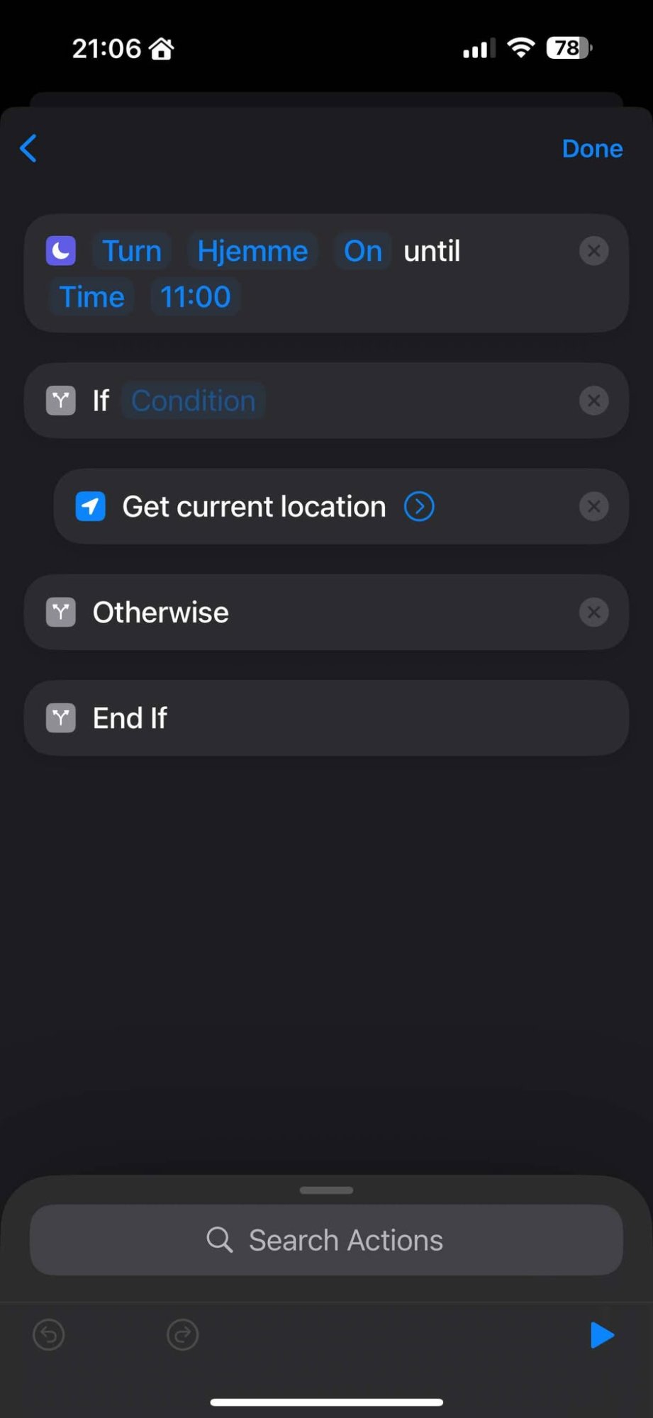

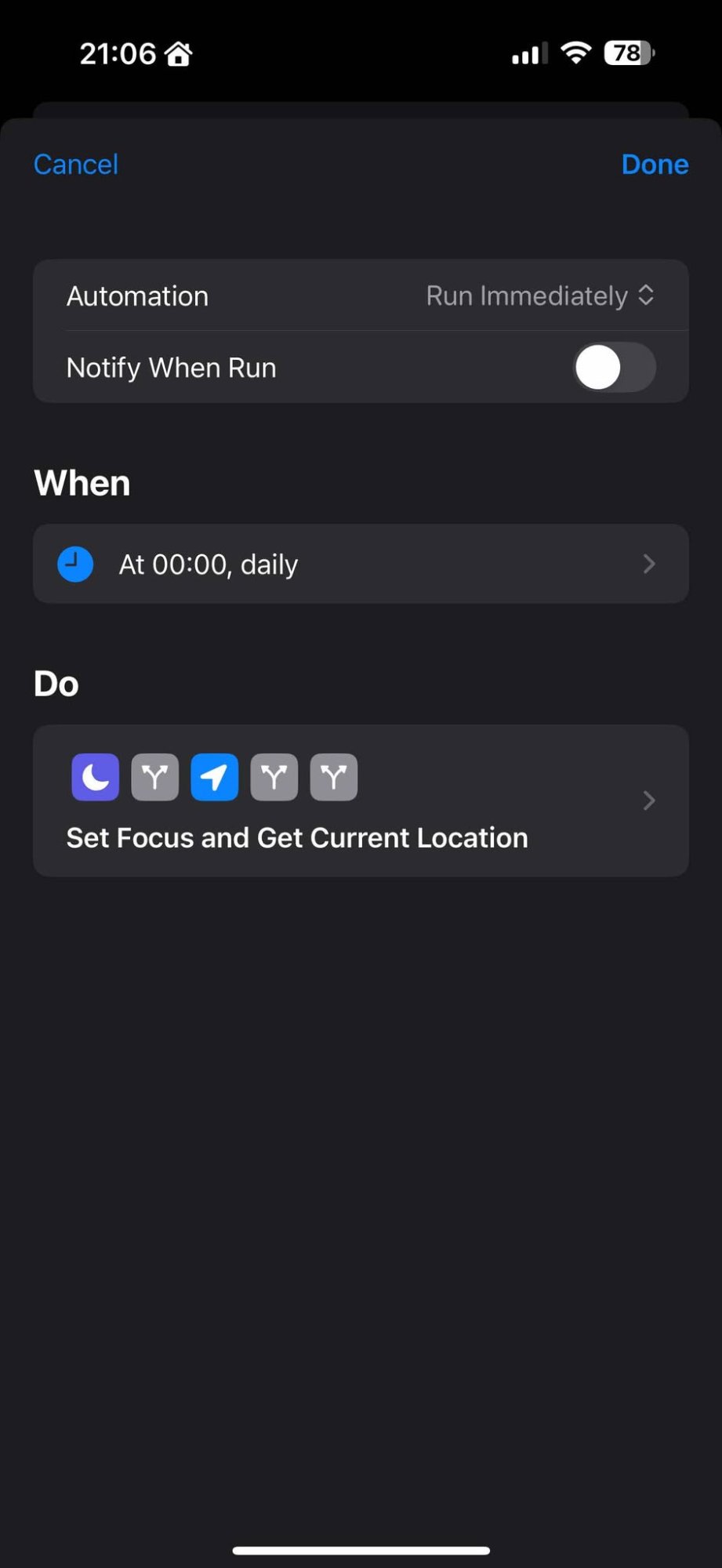

I tried what you said, for the first step. However, I don't think I have the setup correct here, as it will now activate regardless of location.
I belive it's correct that the first section says "Turn Hjemme (home in Norwegian) on until Time 11:00", but I feel that I'm missing something in the IF section, I have "Get current location", but it should be more?
Again, I'm very noob, so sorry for the basic questions
