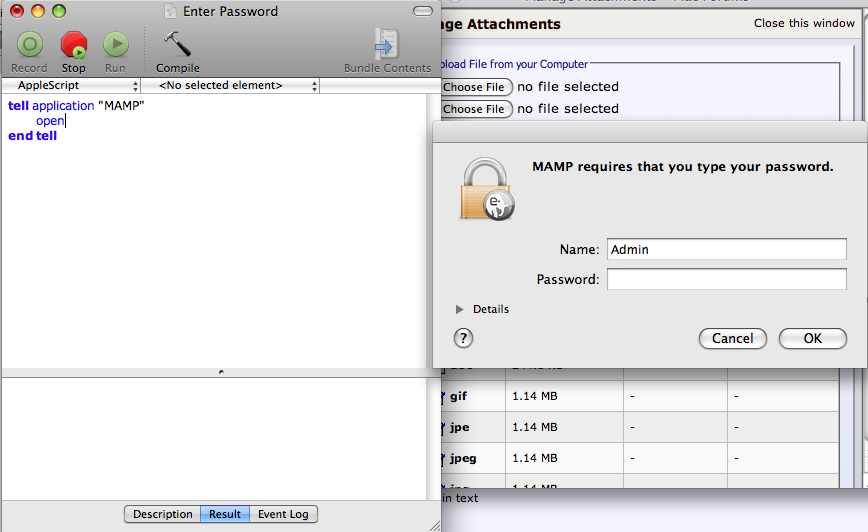

tell application "MAMP"
open
end tell
This opens the application, but gives you the password window - see the attachment.

Now it's getting messy 🙂
simulate CMD + Tab:
Code:
tell application "System Events" to key code 48 using {command down}

If you want to do it the AppleScript way:
Code:
tell application "MAMP" to open
delay 10
keystroke "password
key code 36
end tell
what it does:
open MAMP
make a delay of 10 seconds to give MAMP time to start, modify the value if necessary
CMD-Tab to the window
enter the password
press Enter
