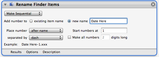

In Automator ...
Files and Folders > Rename Finder Items > Make Sequential
Thank you very much, I have put: get specified items, sort in ascending order date created, then rename sequential.
