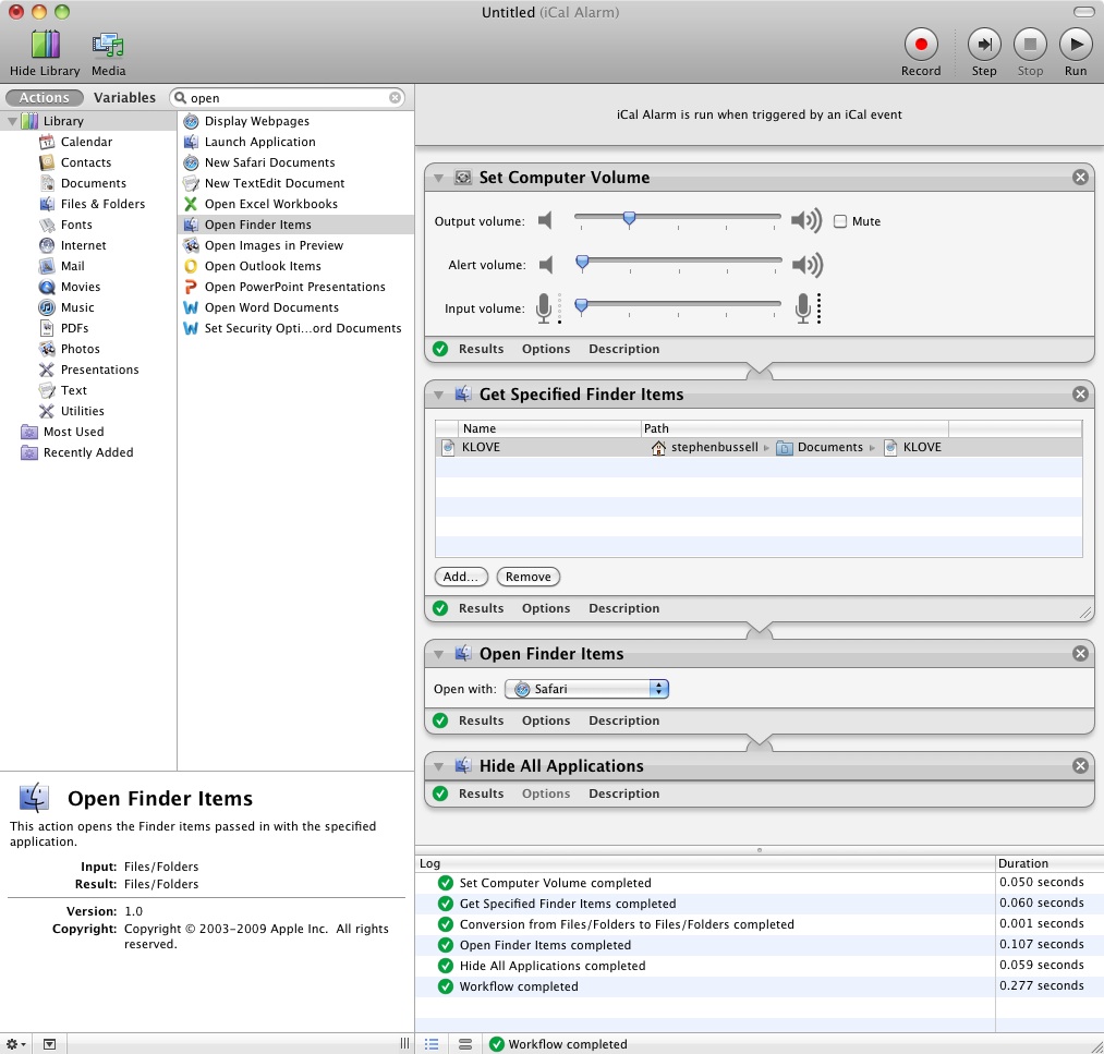

I've been a mac user for years now and recently discovered Automator. I found this to be such an amazing tool built right into Leopard and decided to get creative. All I want it to do is set the volume, open a web page, and hide Safari. I would then use this Automator app to create an alarm in iCal. I don't think it can get any more simple than that. When I create the workflow and test it, it works perfectly. I test it 100 times with no problems. But when I save it as an application and try to launch it, it will work maybe once or twice, but after that it freezes! I'm getting really frustrated and feeling really stupid about this when it should be so simple!! I've attached a pic of my workflow. Any thoughts? Advice? Help?

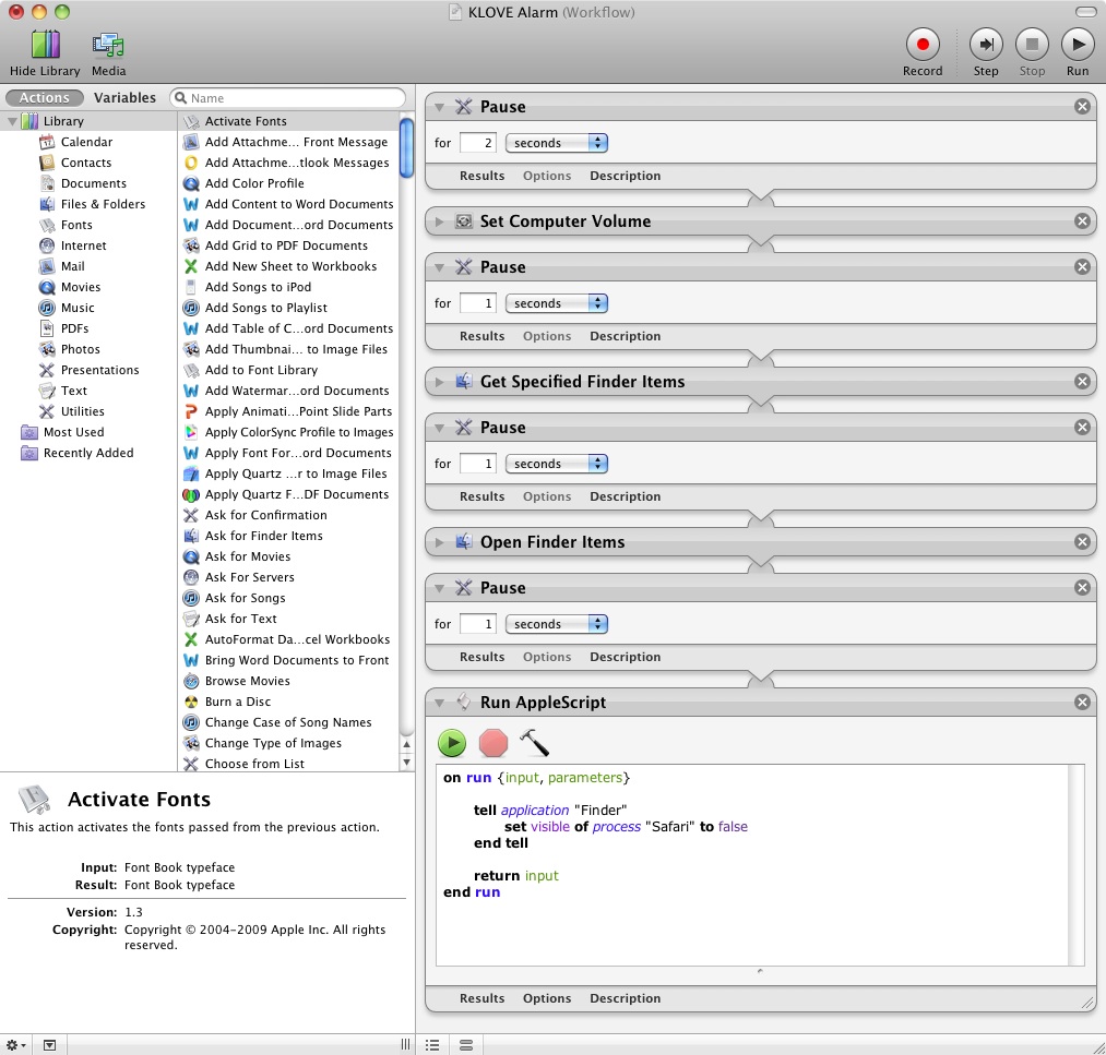

I've had a similar issue - do not why, but I fixed it by adding a couple of pauses between commands - kinda let things catch up.
Purely trial and error on my part.

Thank you so much! I put a 2 sec pause at the beginning and then a 1 sec pause between steps. It now runs exactly how I want it to! In the process, however, I did discover another very interesting problem... After running the application once, the "Hide" function in Safari becomes disabled. "Hide" can then be re-enabled by completely quitting Safari and then relaunching it. But after a few minutes of education on Apple Script, that problem was also solved by creating a short script to hide ONLY Safari rather than hiding all applications.
