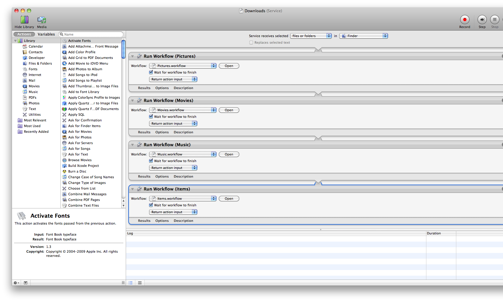

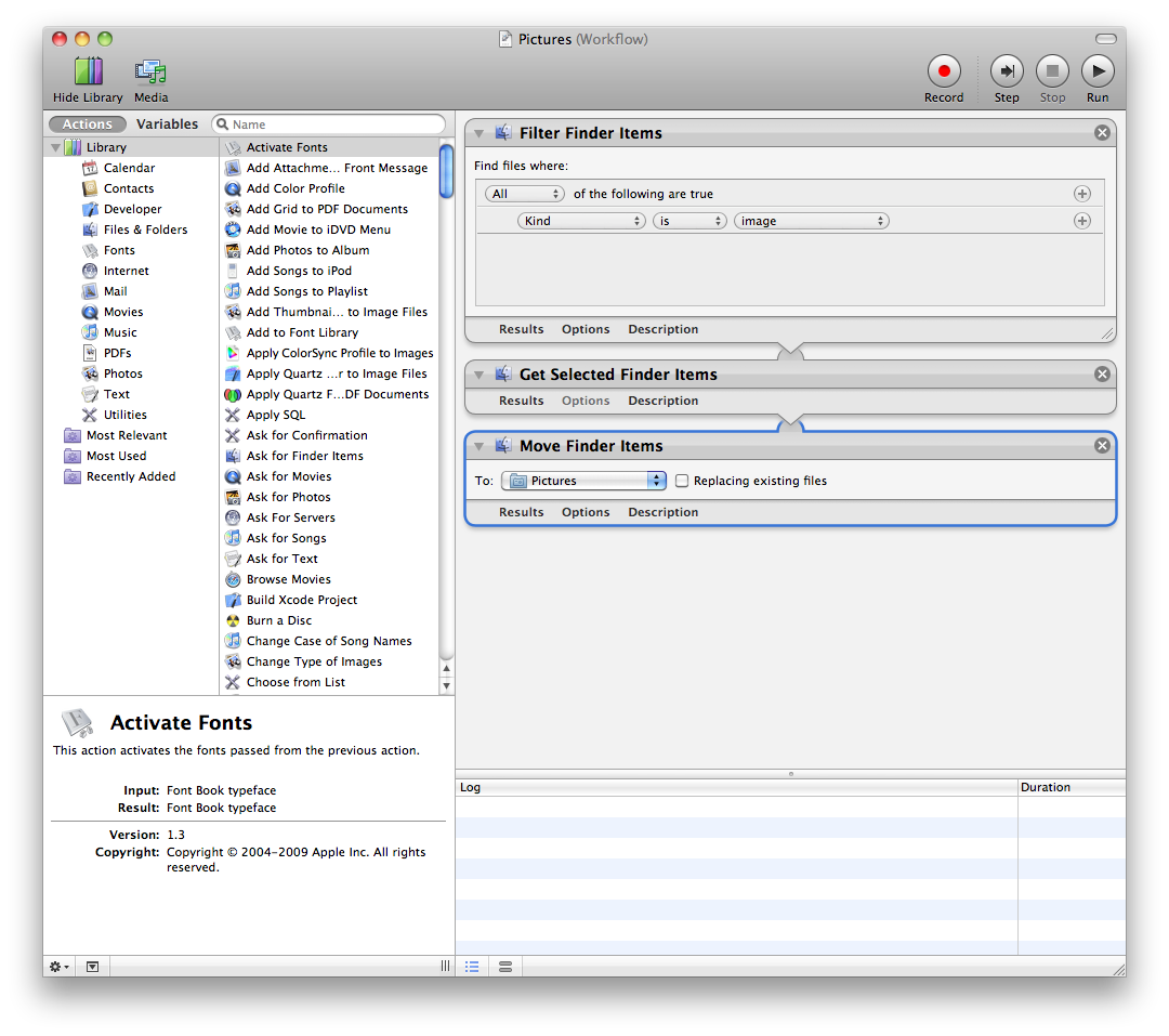

I have the main script running separate workflows. Each one takes the selected input and filters it against what kind of item it needs, such as an image or music. It then moves the item into its appropriate folder.
This almost works. A problem I have is that if one item is selected in the Finder and then I run the workflow, is that it starts to use other items too, even if they are not selected. Is there something special about the service command, or is it not intended for single items?
Here are pictures of the Automator workflow. There is the main workflow, and then the individual workflows for each filetype. Is this the right way to do this?
Thanks for all of your help.
You'd need a separate workflow to handle selected files. I'm not sure how Automator alone will be able to decide what kind of file it is and then move it to the appropriate folder. You might still need AppleScript.
