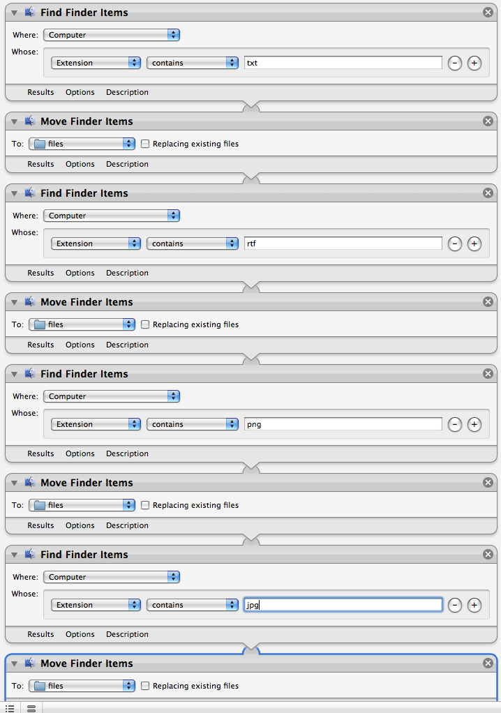

I want to set up a quick action on automator that it would search my whole computer for .txt .rtf .png and .jpg files and move them into a folder on my desktop called "files" can someone please give me a quick step by step guide on how to do this.
Help Appreciated, Thank you.
Screenshot. However, I will caution you and ask you if this is something you really want. There are alot of those file types used by the system. If you run this automator action you will move all of them and your system might start behaving weirdly.

OK yeah I agree that could crap up my system, so I want to search through my user (home icon next to it) e.g. desktop, documents, movies but not the library folder, may you please help.

You'll have to repeat the following 4 step process for each of the 4 file types, so your automator sequence will have 16 steps.
Step 1: Get Specified Finder Items, Add all the folders you want to search to the list
Step 2: Get Folder Contents (make sure "Repeat for each subfolder" is checked)
Step 3: Filter Finder Items, Name Extension is jpg
Step 4: Move Finder Items
