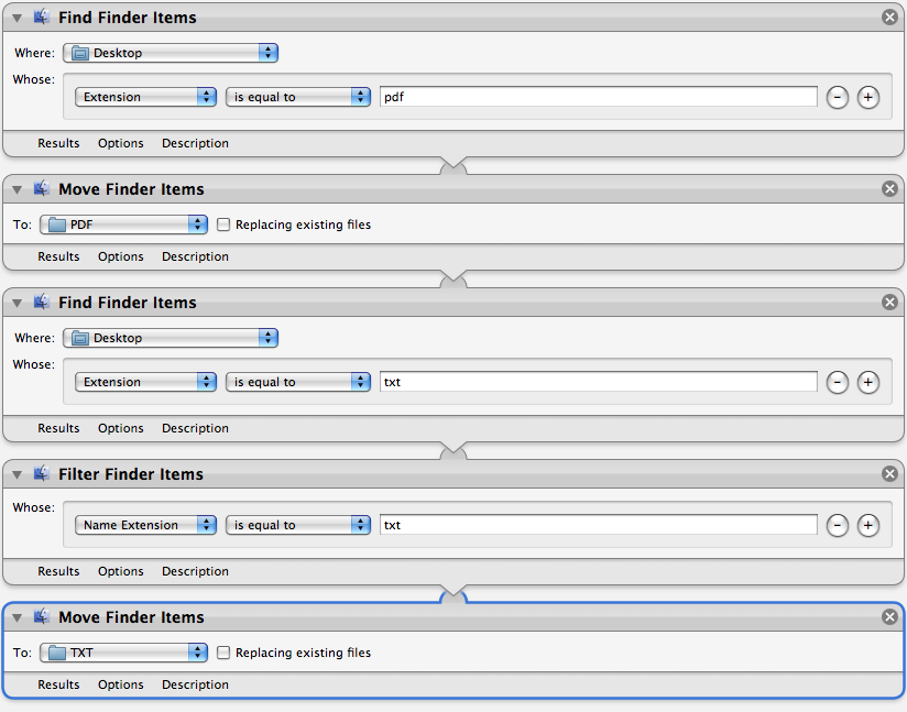

Hello, I am trying to create an application/workflow that will scrape my desktop of jpgs, ai's, pdf's, and psd's, and place them in designated folders. I have so far put together two of the workflows, for ai's and pdf's. When I push play, it runs through just fine, however it is putting the ai's, and the pdf's in the same folder. I am confused. Here is a shot of what I have done so far that is not working right. Any ideas?

So, I actually set up a test case to see what happens.
It completes the first part just fine, but then when it gets the 2nd batch of files and moves them to the 2nd folder it moves the first batch of files from the 1st folder to the 2nd folder. I even added a pause, but it makes no difference.
EDIT: Found a solution. After your second "Find Finder Items" command, put in a "Filter Finder Items" command, and set Name Extension is equal to ai.

Hmm, strange, in my test run I got it to move a pdf to one folder and a txt to another folder.

Did you look at my workflow in the previous post.
As a diagnostic tool, put a 10 second pause between each step, then open up a bunch of finder windows, one for each folder where something should happen, then monitor those folders throughout the workflow, this will help you diagnose which step is causing the problem.
