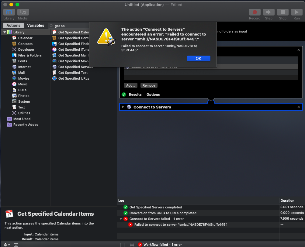

I'm using Automator to connect to server share, however it doesn't fails to connect over 445 after entering details, while "Connect to server (CMK-K) works
"Get Specified Servers" is set as smb://server/share:445
When the script runs it asks for credentials but then fails, even though its right
When using CMK-K from Finder it only works *without* 445.. dialog appears and it connects after the fact as admin. So port number if the issue
If i leave out port number in AUomator it connects, but then as read only.

I'd expect the syntax to be smb://servername:445/Sharename. If I try to connect to smb://myserver/sharename:445, it fails because the share name is unknown, but smb://myserver:445/sharename works fine.

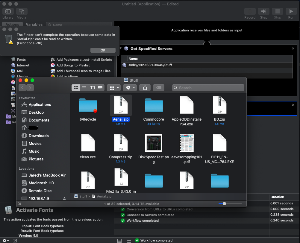

Tried it again ... Can only connect via IP and but as read only from Automator

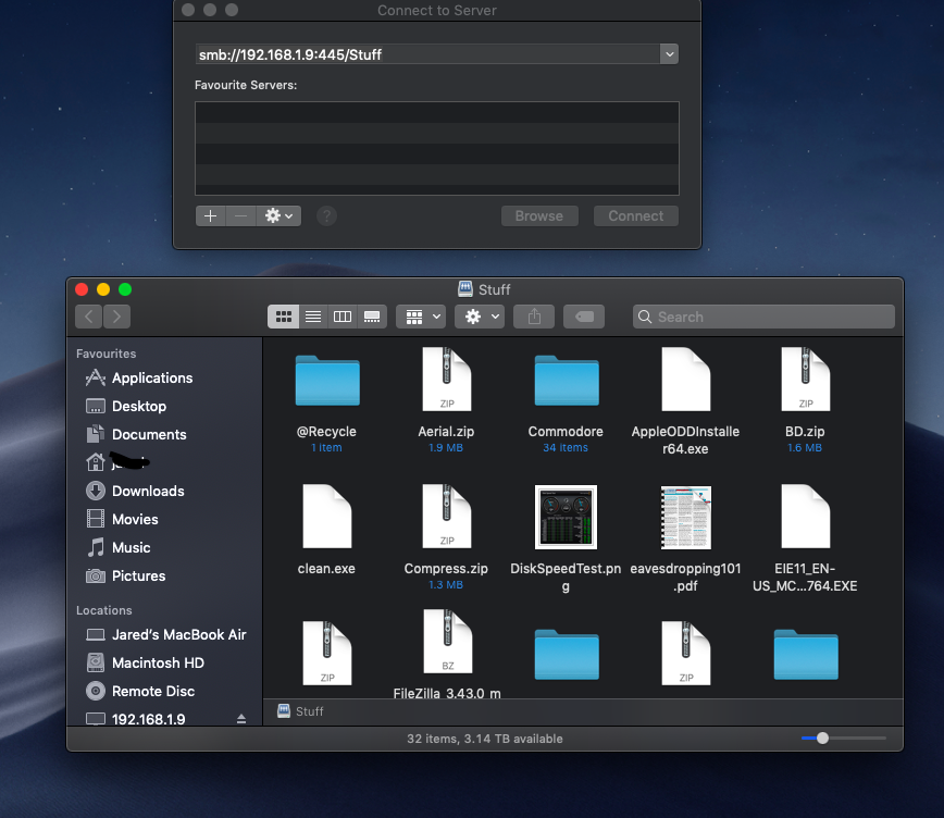

I cannot connect via DNS, unless i open Finder sidebar. Example shows trying to trash file after. as a test.
Works fine via CMD-K
