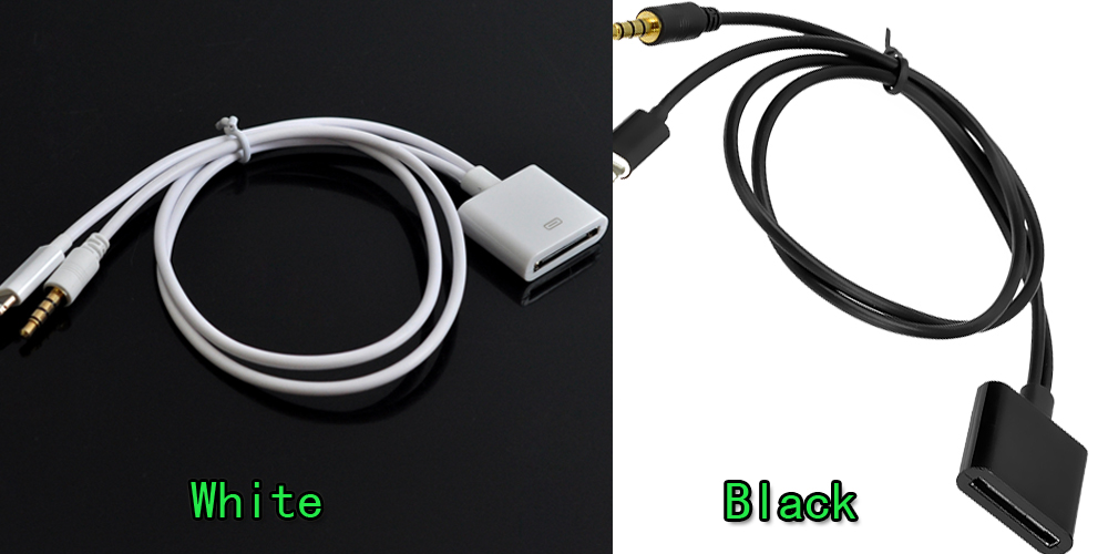

Has anyone seen a lightning cable version of this?
White_USB_3.5mm_AUX_Audio_Data_Charger_Cable_for_iPhone_4S_iPhone_4_iPhone_3G_3GS_iPod_Cell_Phone_MP3_amp_MP4CES12582.jpg
I gave away my 30 pin version when the iP5 came out, but it is annoying plugging and unplugging two cables in the car.
I just use the one I have with the lightning cable adapter. :) I kept all my old 30 pin accessories. But no I haven't seen one.
Same issue here. Have dock adapter which doesn't fit my case. If I find one ill try to remember to post what brand.
Long 5ft iPod / iPhone 2-in-1 Audio and Sync Cable. Apple Dock Connector to 3.5mm Audio AUX (Auxiliary) Connector AND USB Charge/sync Connector

Really want one of these.

The reason I don't just get the adapter is that my old one finally crapped out, and I was waiting to upgrade from the 4S to 5S before getting a new one (with lighting connector), and assumed these were also available, but I havent been able to find one yet.
I suppose I could get a new "older" connector and buy an adapter, and then at least my wife could also use it with my inherited 4S, though she's not going to use the car much.
OK, I found the reason why (or maybe everyone else knew this, and I'm just the big dummy here)
The lightning interface only has digital audio output, whereas the old 30 pin interface has an analog output, which is why there is not an exact lightning port product like these for the old 30 pin output. So, you need an adapter that includes a digital to analog converter in addition to the type of adapter like post #5. The expensive Apple adapters have the D/A converter, many of the cheapy ones do not.
So the solutions are: use a lightening to 30 pin adapter (that has a D/A converter) with the older 30 pin charging/audio out combo cable, or use a USB lightening cable to charge and a separate audio cable plugged into the headphone out.
So a cable manufacturer could make one of these for the lighting, but it would also need a D/A converter in it as well.
This really sucks. The Apple Lightning to 30pin adapters don't work with a case, so now I need to get the Apple adapter cable ?

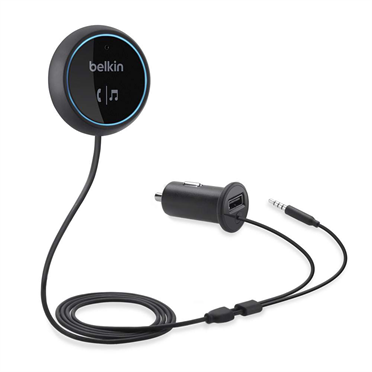

I decided to go a completely different route.
Rather than spending $40 on the Apple adapter cable, I'm going to get this ($45 on Amazon):
http://www.belkin.com/us/p/P-F4U037/
Now I can use one of my many Lightning cables to charge, and audio all goes via BT to the car stereo (connected with 3.5mm aux out).

I went ahead and ordered that Belkin Bluetooth. That looks like a great option. No worrying about cases and docking.
I've got the Belkin bluetooth and it's okay but the giant button kinda sucks. It's hit or miss whether you'll end up pausing the music when you try to skip. If I could do it over, I'd get the Kinivo instead.

My Belkin came and I am happy so far.

I like the magnet holder and you just have to be more deliberate on the skip sequence.
My only issue is that I get dropouts from time to time. It may have more to do with the bluetooth connection in my car (it is a 2008, supports phone but not music).
I'll need to try disconnecting that to see if it helps the issue.
I'd rather have the car bluetooth for phone calls because it displays the caller, of course.

Question about this - isn't it a bit redundant to have it go via BT with another device? I mean, natively the iPhone can connect to cars (that allow it) and play music via BT. What's the advantage of this?
Because not all cars have Bluetooth.
This, I know. But, looking at the product page again, it looks like I misread the information. I thought the aux plug goes into the iPhone and then the sound would be transmitted via BT. Apparently, that's not the case, it actually works the other way around. As an aside, BT audio streaming is one of the best updates to the BT profile.
Cool device, I might consider getting it for my dad. Got to see first if he has an aux-in.
Honest mistake, I apologize if I came across as condescending.
I've heard good things about the Belkin, the only issue I've read about is after a few months some people report drop outs a lot
