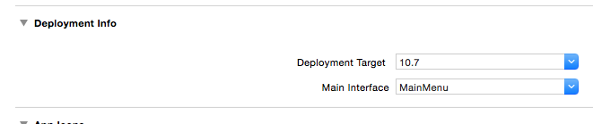

Have you set a deployment target of 10.7? At most I'd expect a possible warning that the instance method is deprecated.
Yes, I have always had it set to 10.7 since that is what I use my apps in mostly. It gives me no notification that it will not work on 10.7. There are no errors besides the new one that gives me an error trying to use the depreciated finishedWriting method.

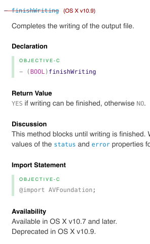

In the 10.9 SDK the finishedWriting method was not on the list of Methods for the AVAsetWrite Class. A snap shot of the Docs introduced in 10.7 and 10.8, gone in 10.9. If that method is no longer available in 10.9 then it would not be a method that I can use, as for as I know. My first problem was I was trying to use the method in the AVAsetWriterInput Class and it never existed there in the first place. So I imported the 10.7 SDK from Xcode 4.3 and was frustrated again because it would not work!!! Then I had the "Douh" moment when I realized it was never in the the AVAsetWriterInput Class, it existed in the AVAsetWriter Class.
You could be correct. Perhaps if I had realized I was using it in the wrong class first and switched to the correct class before I did all the importing of the 10.7 sdk and switching things round, it might have worked. I suppose I could switch back to the 10.9 frame work and see if that method is available.

Try the newer SDK. It should work fine for your target of 10.7 and newer. Depecated methods may never disappear and if they do, it will be several OS and SDK iterations.
