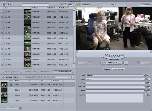

It's really very easy to import your AVCHD footage - you plug in your camera, bring up the Log & Capture Transfer window (see attached image), select the clips you want to import and off you go. FCP will convert them into ProRes 422 or AIC, depending on what you choose (but FCE will only convert to AIC). What you do have to be aware of is that the import process can take some time on slower computers, and that the imported footage takes up massive amounts of space. I can't remember the exact figures, but I think 8GB of AVCHD footage can end up as something like 50GB once converted to ProRes 422. Once converted, FCP has no problems with the footage - other than it being slower to work with than something like DV in regards to rendering etc.

Where is Log & Capture? I have never seen that Screen!

Woops! That should have said Log & Transfer - Log & Capture is for transferring footage from tape. My bad 🙂
To bring it up just go File -> Log & Transfer.
The Log & Transfer window is only available in Final Cut Pro/Express, the software the OP was asking about.
