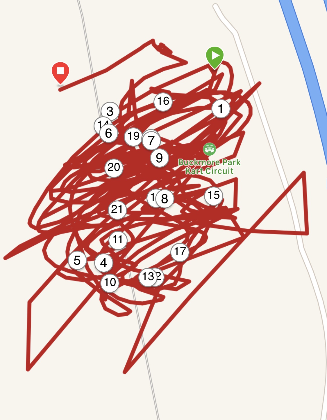

Here’s the GPS plot from the Fenix F3

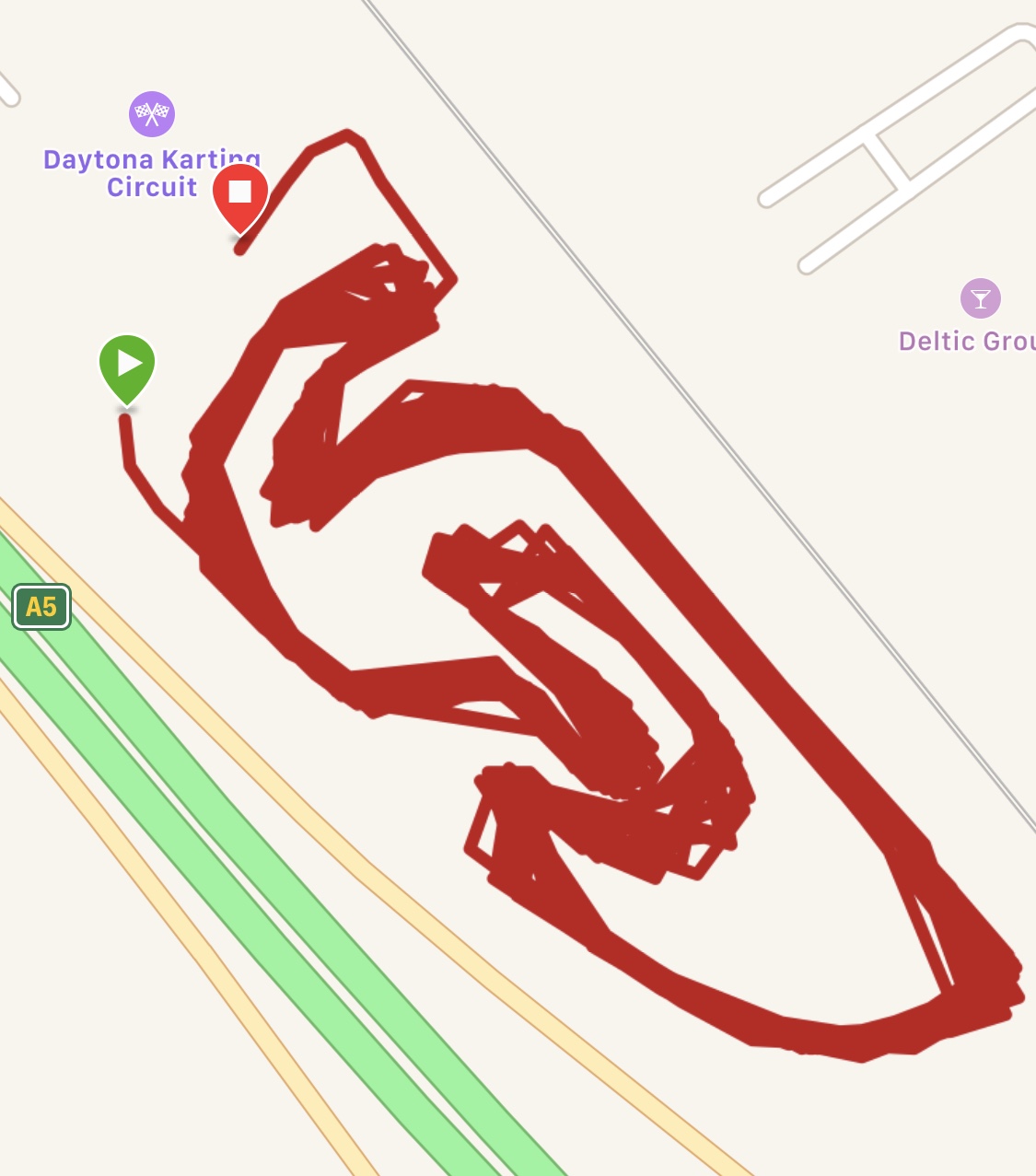

And from the AW S3 (all be it a different circuit)
Definitely some difference.

I've just had a look a a GPX file from one of my runs recorded on an Apple Watch. GPS data comes in around every 2-3 seconds (and that's with a good signal) so looks like its just not suitable as oeagleo says.
