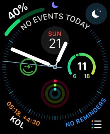

I just got my series 4 last Friday and I really love it. I have been using it for sleep tracking with Pillow. Usually the battery drops 10% over night, which is fine. But this morning I woke up to 6% where I actually fully charged before bed. I was trying to identify the root cause but the apple watch app doesnt tell much. I can see the active use is 2 hours and standby time 7h after last full charge.
I am wondering anybody else is experiencing the same issue?
Been wearing the watch since about 9 in the morning and now it’s 1 in the morning the next day. So that’s about 16 hours with about 3 hours of constant music and data / cellular connection usage today and the watch is still at 40%
did you use infograph face all the time?
