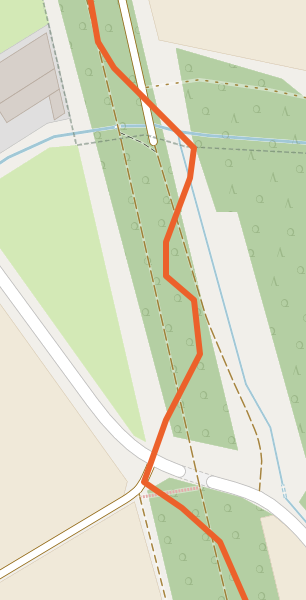

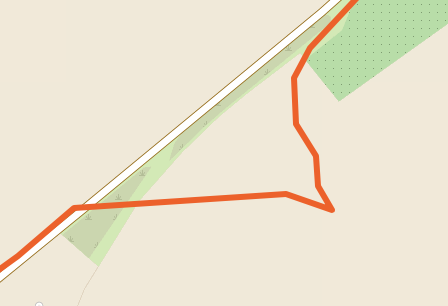

Did a 14km run today with LTE on. A mix of difficult and easy conditions.
Mostly, the track is ok, not as good as with LTE disabled.
But two quirks:
