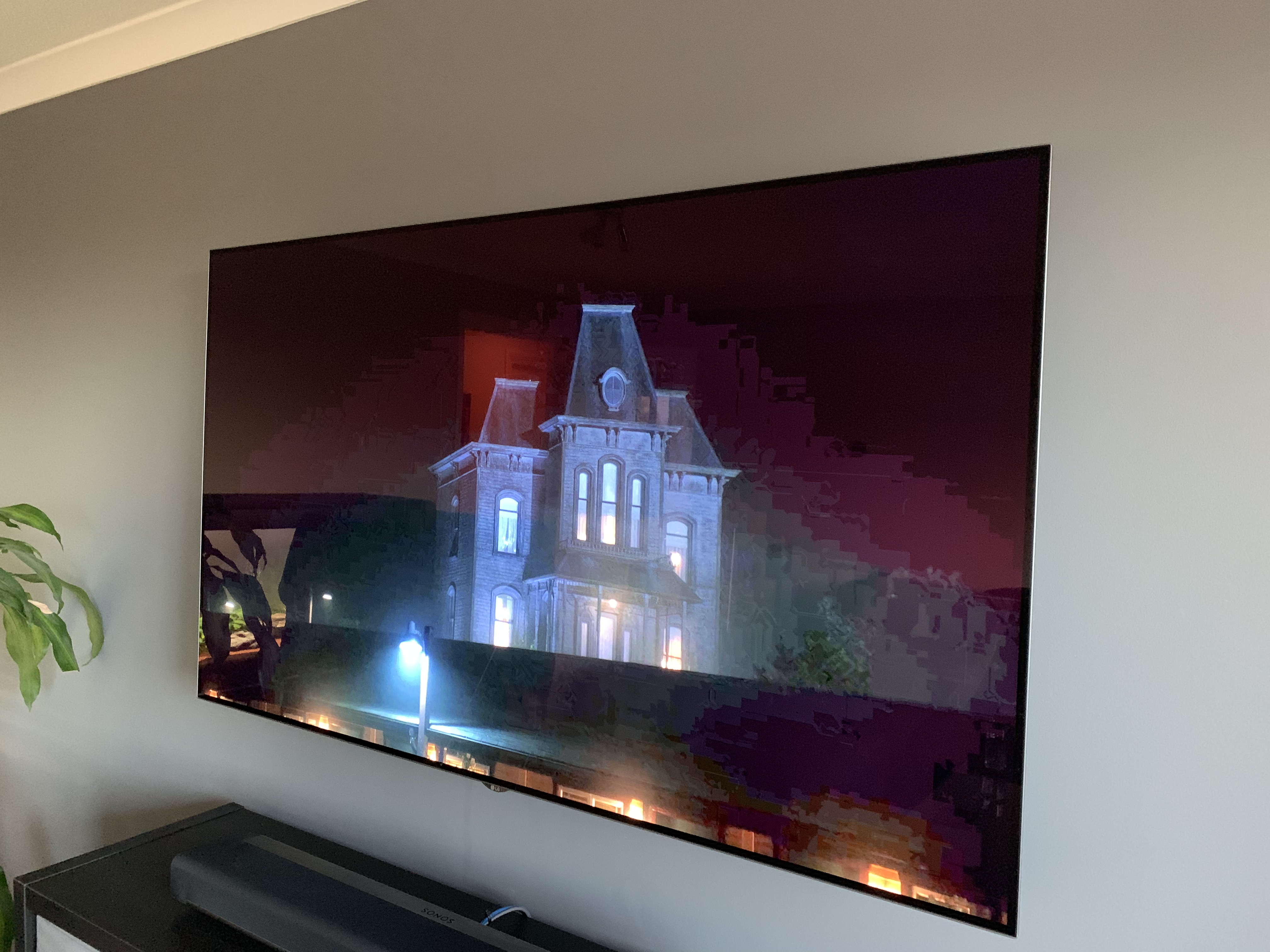

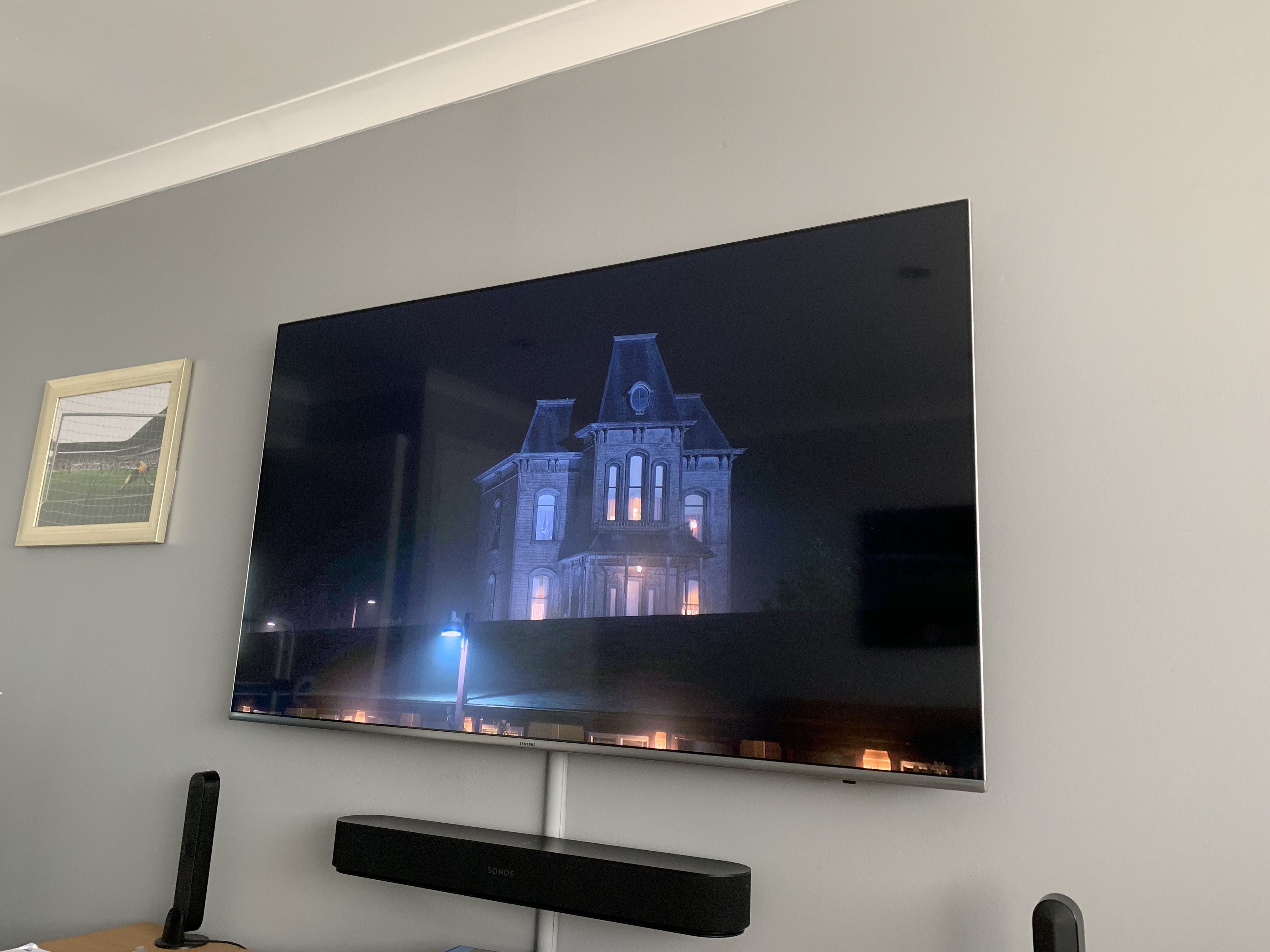

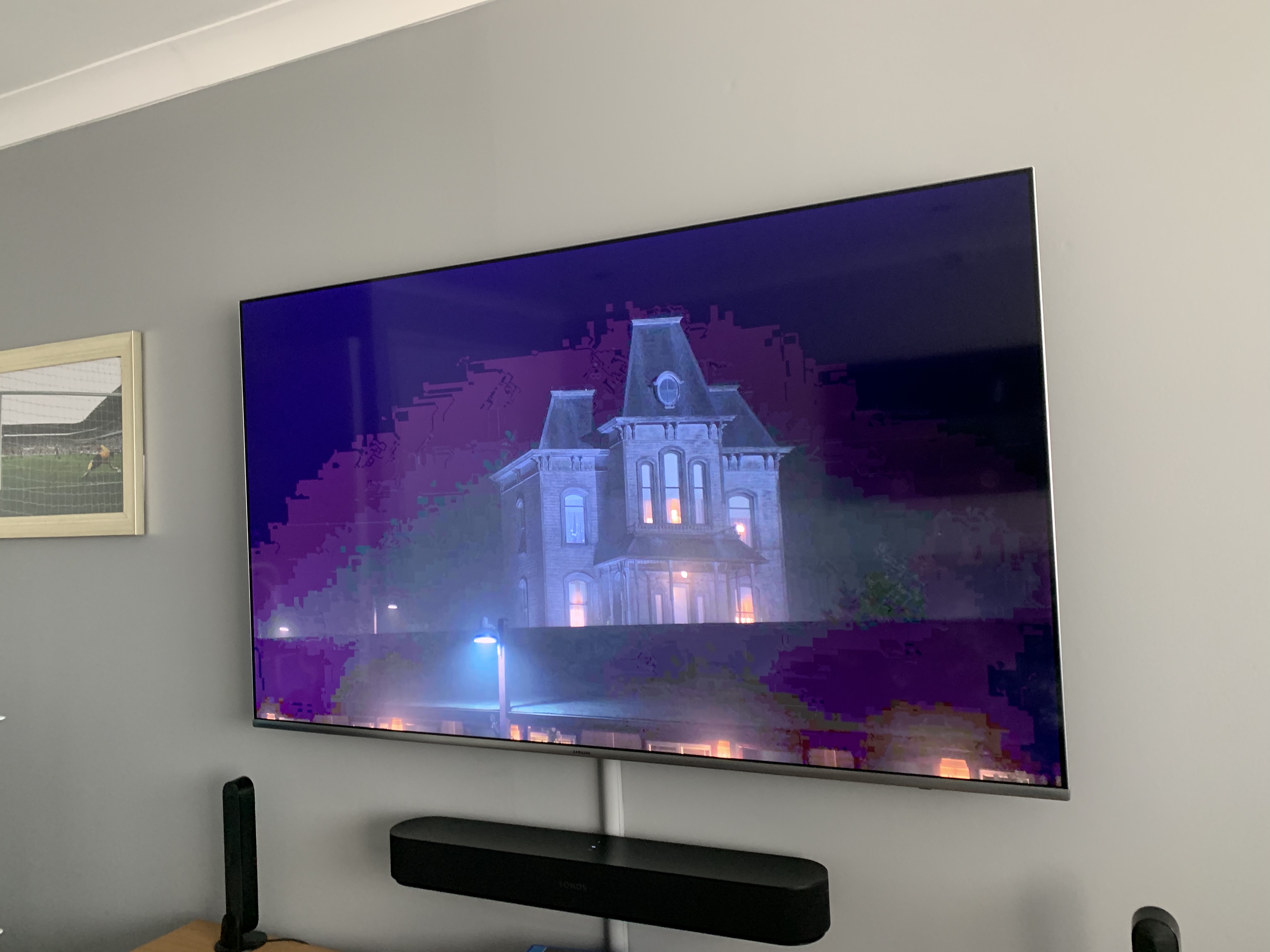

I’ve recently noticed that when using my Apple TV 4K for Netflix the image quality is very poor especially in darker scenes - at first I thought it was my TV but I tried on another TV (With a different Apple TV) and have the same issue. Have attached some images below - the last image is the same scene but through the Netflix app on the TV rather than Apple TV showing how it should be! Any suggestions what it could be?

It’s happening on my Samsung Qled tv and LG Oled - I’m watching Bates motel, the scene in the pictures is from Season 4
episode 1 at 30min 45 seconds.
Have HDR enabled on the port, on Apple TV it’s set to 4K HDR 60hz and chroma is 4:2:2.
What I’m watching is only HD - but then it displays fine on the 3rd picture which is the Netflix app inbuilt to the TV.

I just tried it with my LG OLED.
it looks just like your pictures with the output set to HDR
when outputting SDR, it looks like the pic from your internal player.
you need to turn on dynamic range matching.
It's the aTV converting the SDR to HDR, that creates the banding.
The player in your TV is playing straight SDR
