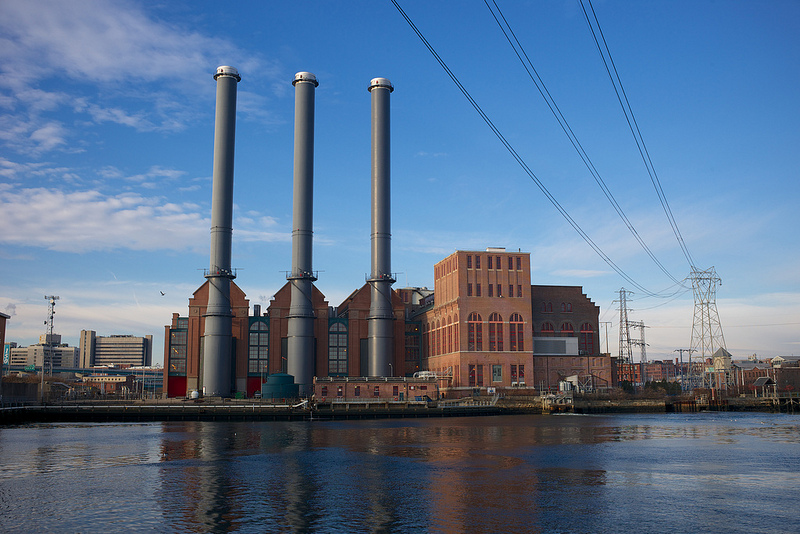

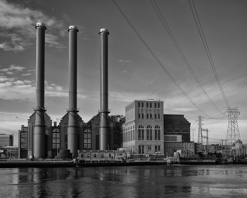

These two shots were taken on different days. Similar framing between the two, but the light was very different.
The right light makes or breaks a photo. One of the basic rules of photography, but it really can't be stressed enough. I also like the sky better in the second with the clouds. And while there is a gull present on the left side of both, its placement in the second photo is much better. Right place at the right time.
Bad light. The sun was hidden in clouds, making the stacks fairly uniform in tone. Kind of ho-hum.
Better light. The sun was peeking through some clouds varying the tone of the stacks. Not harsh enough to add significant shadow lines to the building, but introduced some variability to the appearance of the stacks.

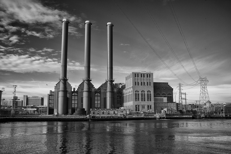

There are haloes in both of the following. Modest in the full dynamic range conversion, more pronounced in the high structure conversion.

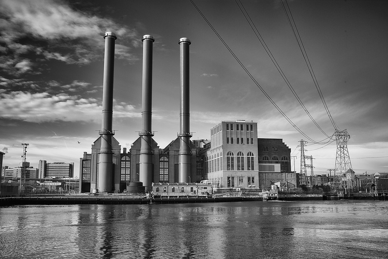

Full dynamic range. While the haloes are subtle, also note the fairly dramatic breaks in the shadows as you move across each stack. Clear lines rather than gradual transitions.
High structure. Haloes are more obvious as are the shadow transitions as you move across each stack.

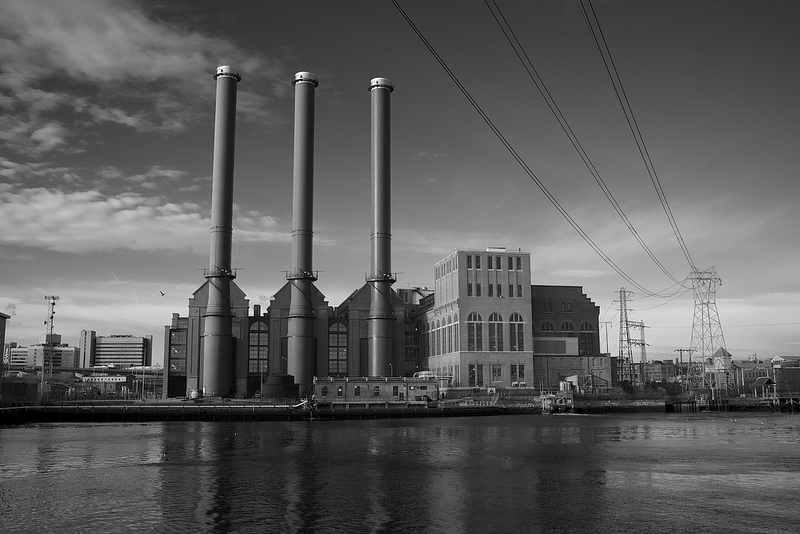

Neutral conversion with a yellow filter applied to darken the sky a bit. Minimal haloes, smoothest shadow transition across each stack.

I like the full dynamic range one best. I to use Silver Efex Pro. It's the best B&W conversion software around IMO.

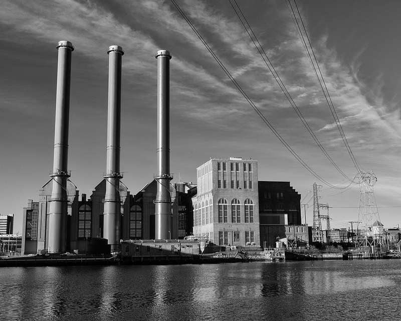

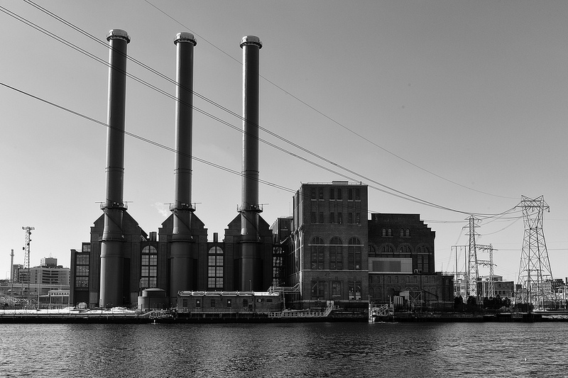

Fugi ACROS neopan 100 with green filter. Very neutral version. No halos present.
Neutral conversion with a yellow filter to darken the sky. Subtle halos around the power lines, though the lines themselves are still black.
Full dynamic range. Notice the very obvious halos around the power lines. The sky is "magically" brighter in well demarcated areas around the power lines.
High structure. Again notice the very obvious halos on the power lines. This isn't so much in the areas around the power lines, but the lines themselves are ghosted with white lines which also aren't natural.
Personally, I like this second-last one the best. I like plenty of contrast in B&W shots & this one retains great shadow detail in the buildings and the water.
I agree that the sky doesn't look completely natural though. Where I notice it the most is in between the 2nd & 3rd stacks where the sky doesn't darken with a natural gradation.
You mentioned above that you have photoshop - I've never used Silver Efex Pro, so I don't know how it creates its masks, but you may find that you can create similar results while avoiding the haloing by using Selective Colour adjustment layers in PS.
Great work - thanks for sharing!
I think the wide works very well especially with the power lines pulling the composition over to the right.

Not really possible to shoot it head-on as the power lines then get into a bad position. There are also issues with foreground elements that don't make it possible to step back too far and try to get a more level view.
There is a way in Nik software (including Silver Efex Pro 2) to selectively apply the filters to different parts of the image. Somewhat similar to creating masks in Photoshop, but a bit more intuitive. Hadn't really played with this before. For most of my images I've just been making global adjustments in either Aperture or Lightroom. Was in NYC this weekend and read a book on using all of the Nik filters while I was on the train. I'm excited about going over many of my old photos and really concentrating on post. High time I learned how to do this better.
