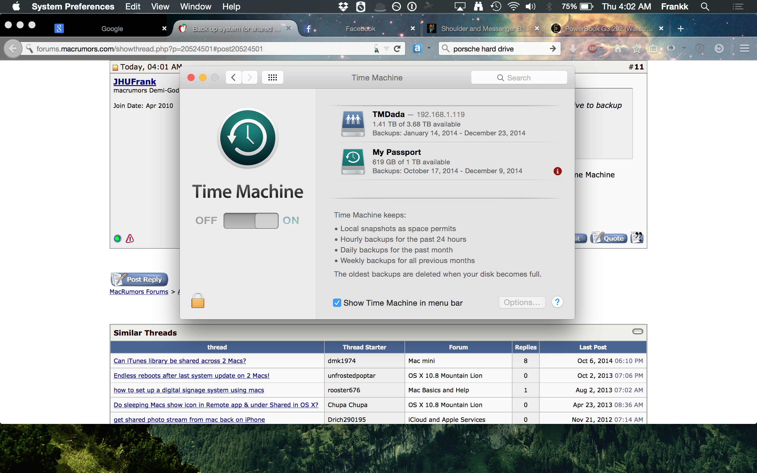

This is a real good strategy. Personally, I have a NAS which I share out on our home network as a Time Machine Destination, and all of our macs backup to it via Time Machine over wifi.
