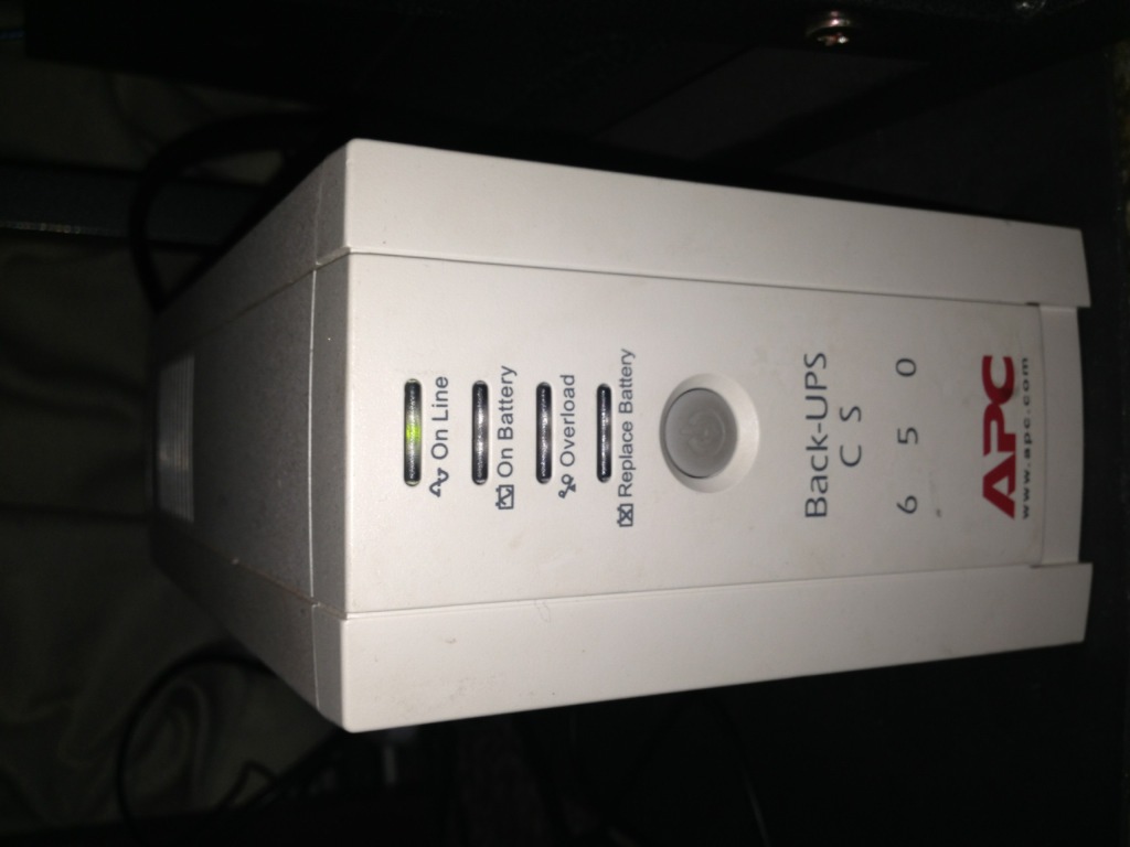

I have tried this 650 VA APC smart UPS and the iMac doesn't turn on at all. Is it too small for the Mac? I hope the next I buY will suit.....What size gives assurance? ImageUploadedByTapatalk 21364664219.886220.jpg
