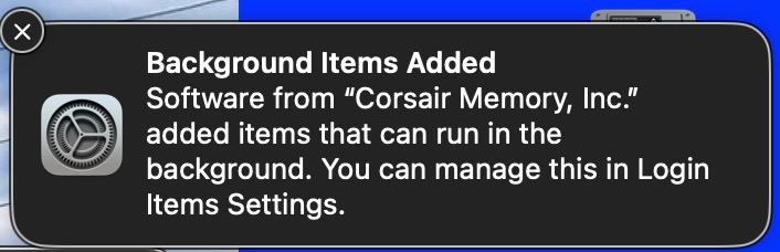

When I do a restart of my 2020 iMac, SSD, macOS 13.1 I get an alert that slides out revealing this:

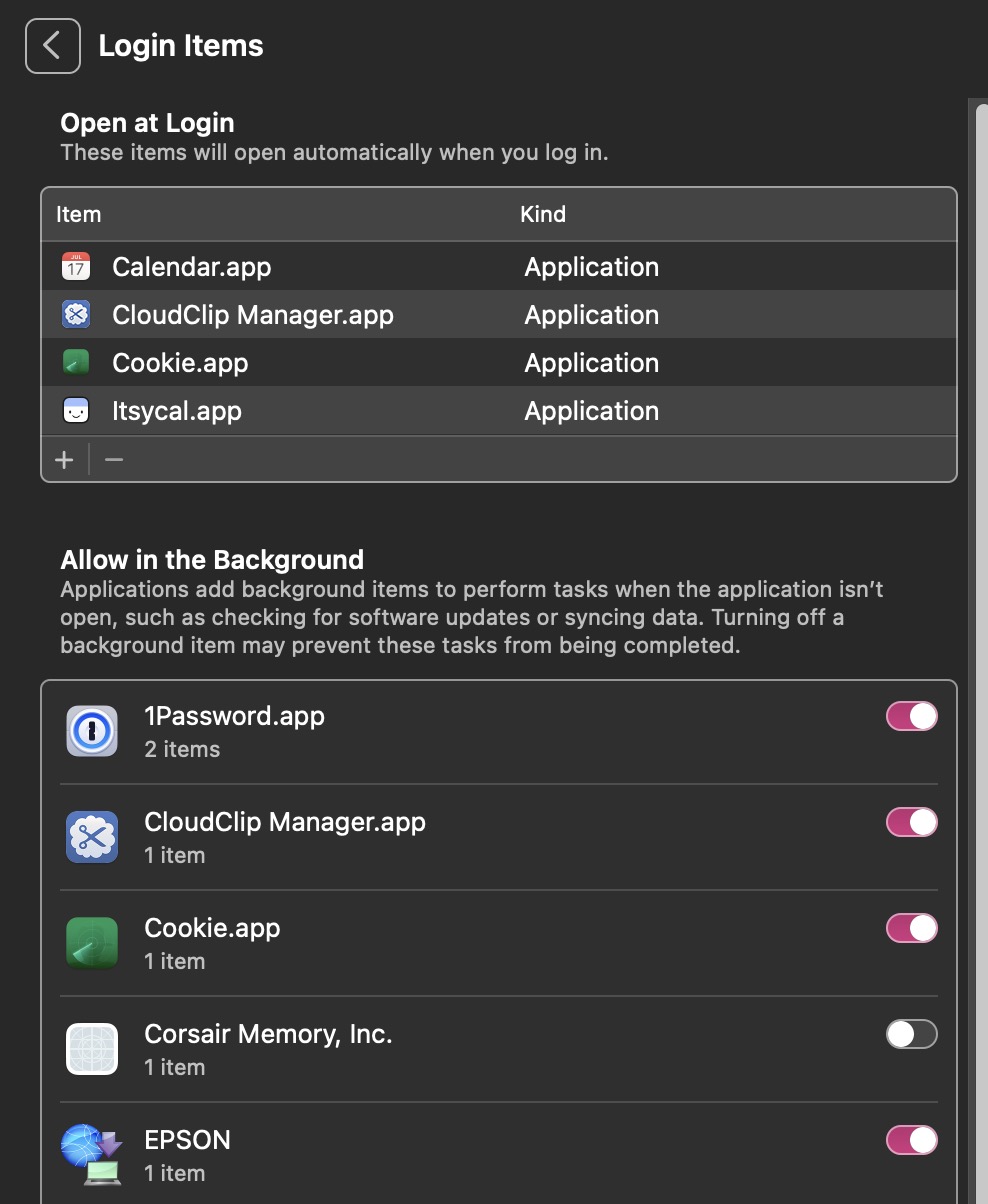

For the record in Login Items in Ventura I have:
• Calendar.app
• CloudClip Manager.app
• Cookie.app
• Itsycal.app
Corsair Memory, Inc., does show in Login Items > Allow in the Background but it is turned to Off.
@bogdanw - Thanks. I went to all of those folders you suggested and found only items which I recognized, none of which had anything to do with Corsair. As if to mock me as I did so, the [Background Items Added] notification appeared on my desktop!
Damn, but this is annoying!!!

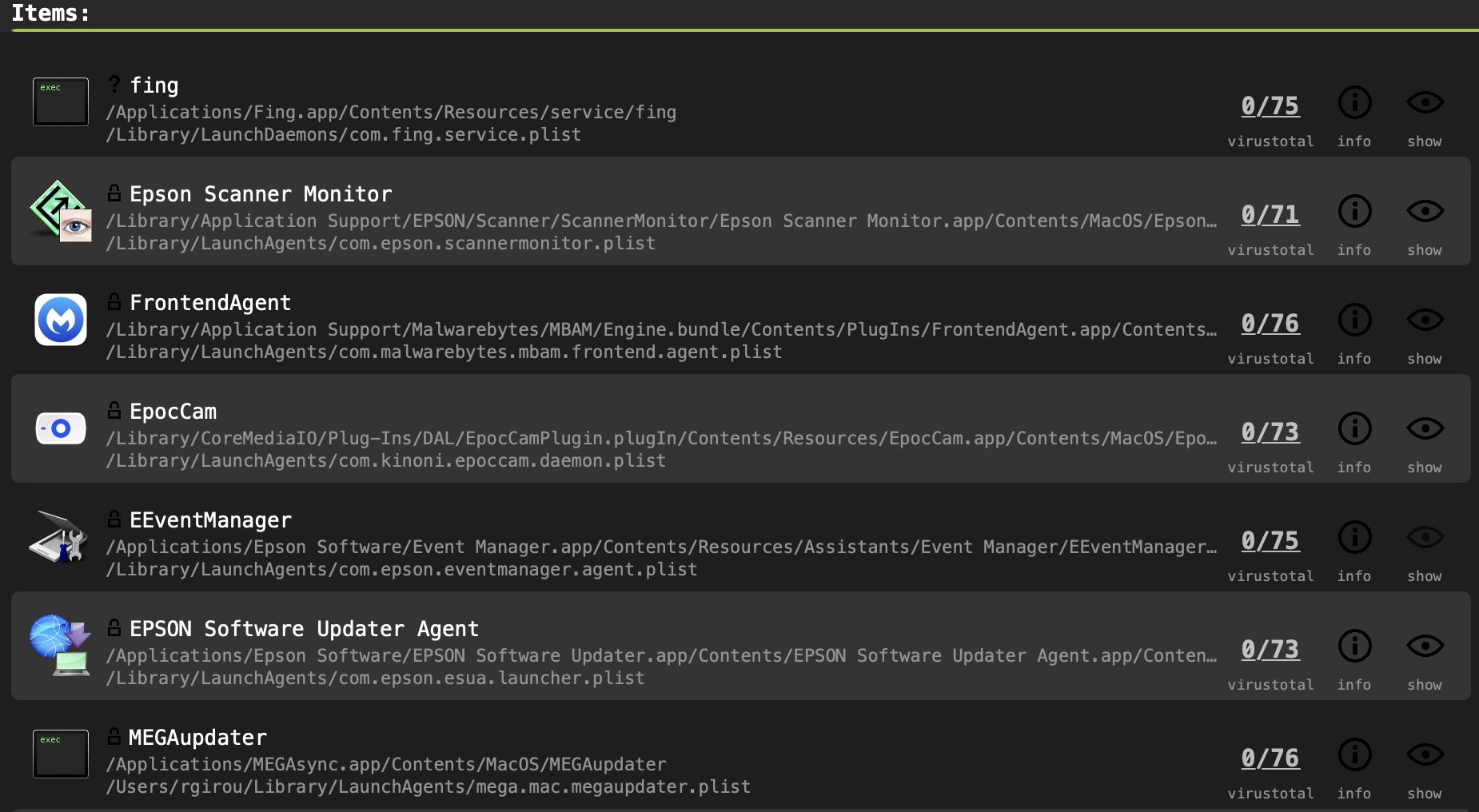

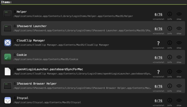

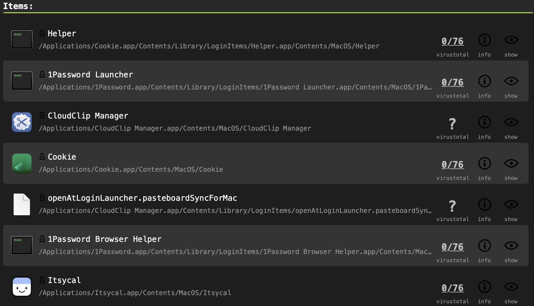

I had KnockKnock installed but totally forgot I did so and so ran it. Still cannot find anything either relating to Corsair; here is everything KnockKnock finds.
LAUNCH ITEMS first then LOGIN ITEMS

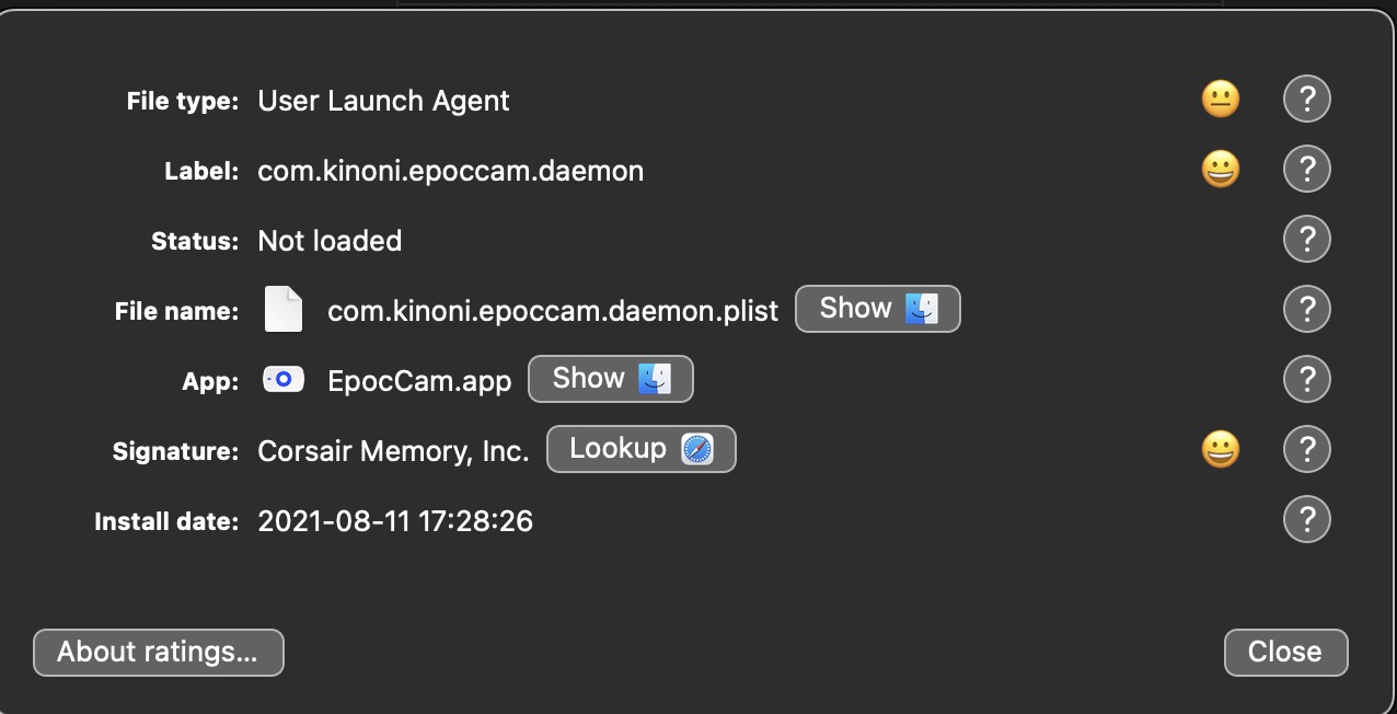

Well, well, well - found it.
Ran EtreCheck, looked at the Launch Agents one by one, for which EtreChedk, bless 'em, provides detailed information.
Look at what I found under Epoccam: [Signature: Corsair Memory, inc.]
Used App Cleaner to remove that App from my Applications folder.
Problem, I believe, solved.
