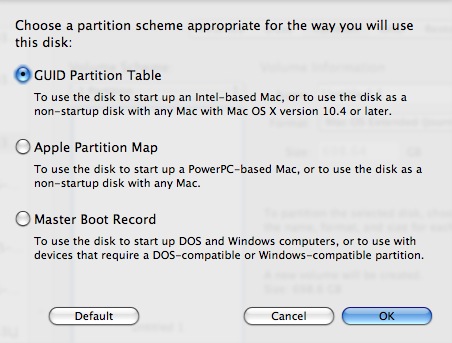

If that is the case, you need to select the device, then use the Partition tab to erase and repartition it to have a GUID partition map (selected in the "Options" button at the bottom) and a Mac OS Extended (Journaled) format.

Just a couple more notes- actually you answered your own question regarding the boot problem. Your drive has an Apple Partition Map as you noted, but that is only good for booting older PowerPC based Macs (see the attached pic of the box that pops up when you choose Options in the Partition tab of Disk Utility for details). You can see from that why I originally said you need a GUID partition map for your 1st gen, 24" iMac since it is Intel based! 😉
If I change the external to a GUID partition map will that erase the disk and force me to clone my internal drive all over again?

Hi- Yes, unfortunately changing the partition map as you need to does erase the disk in the process of the change. 🙁 Sorry- no way around that. Should have made that clearer in my explanation now that I look back on it.
