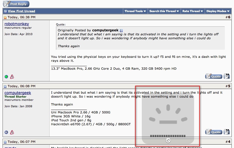

You tried using the physical keys on your keyboard to turn it up? f5 and f6 on mine, it's a dash with light rays above it.
When I try that with mine, even though my backlight works fine, I get this:

Yep it turns up and down and i get that when there is to much light. Could they have missed a plug when putting it back together..
