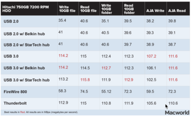

Thunderbolt HDD will be faster than USB 3 SSD
Actually no, benchmarks have shown no speed difference, I'd opt for the least expensive option because performance is the same

Isn't that chart for thunderbolt 1 though? I thought thunderbolt 2 is better?
I thought I saw some TB2 benchmarks but so far I've not found them again, here's what this article states:

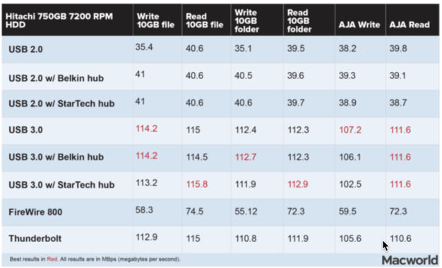

Link
