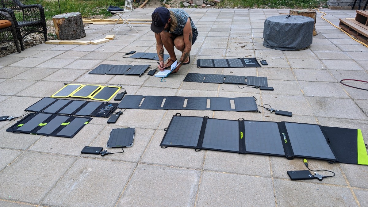

I would get a UPS, some portable USB battery packs, and a solar charger.
Here are some resources to get you started, if you're interested:
Then you'll be protected when the power first goes out and you won't need to directly connect any expensive gear to the generator. Plus if an outage goes on for more than a few hours and there is clear weather, the solar charger can take care of your smaller devices (plus no fuel consumption!).
