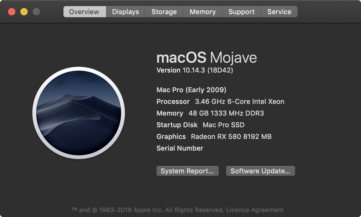

Anyone else having problems going from 10.14.2>10.14.3? I also have a 4,1 with an RX580 and was about to do the upgrade.
No problem during / after the upgrade at all.

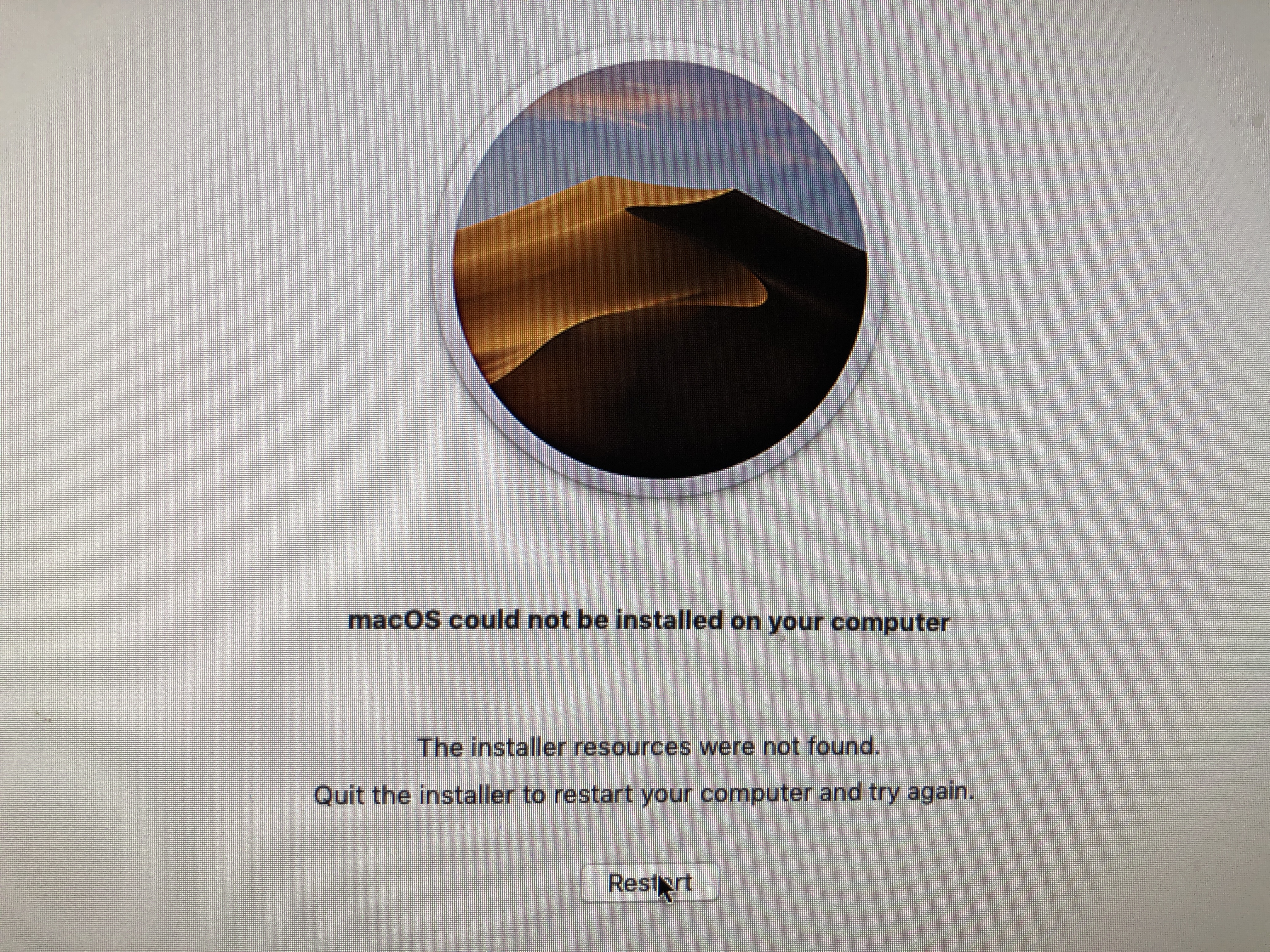

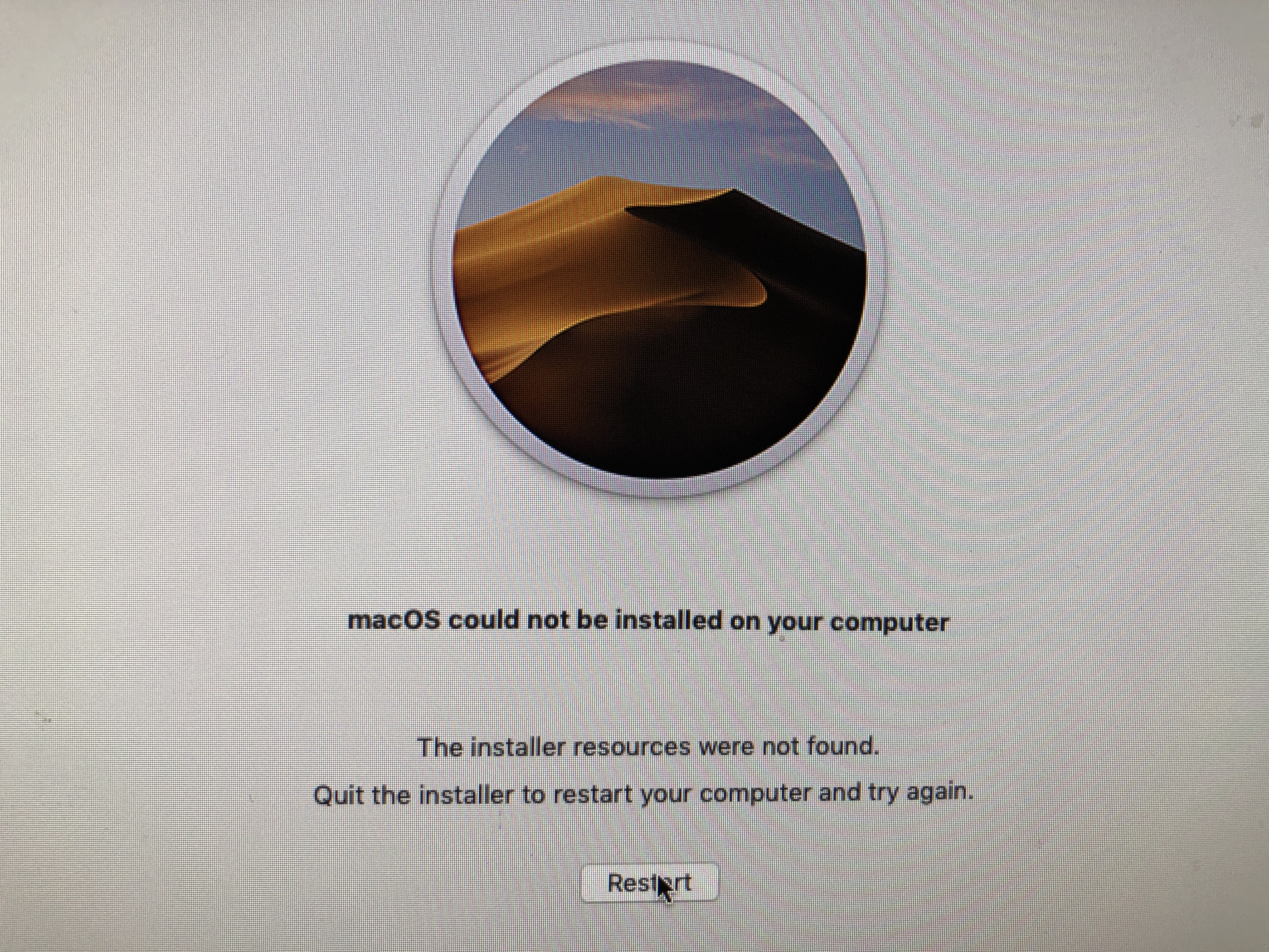

Thanks for the responses. Well, I attempted the update and was unsuccessful. My first attempt was the Combo update from Apple. Then I tried to update through System Preferences. That also failed. Both attempts yielded the same results. So I'm still on 10.14.2.
"The installer resources were not found. Quit the installer to restart your computer and try again."
Suggestions?
Oh - BTW... FaceTime and Messages have stopped working as of this afternoon. This morning, everything was fine.
Suggestions?
You download the combo updater after 25th Jan?
Yes, just yesterday. I actually used the combo update I downloaded to upgrade my wife's iMac first. Then I tried on my Mac Pro with the aforementioned error.
