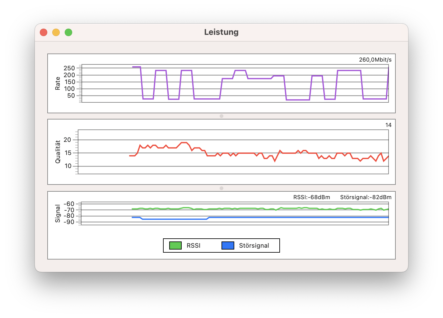

Below I have attached two screenshots of the WiFi signal diagnostic. This is the 16" MBP 2023:

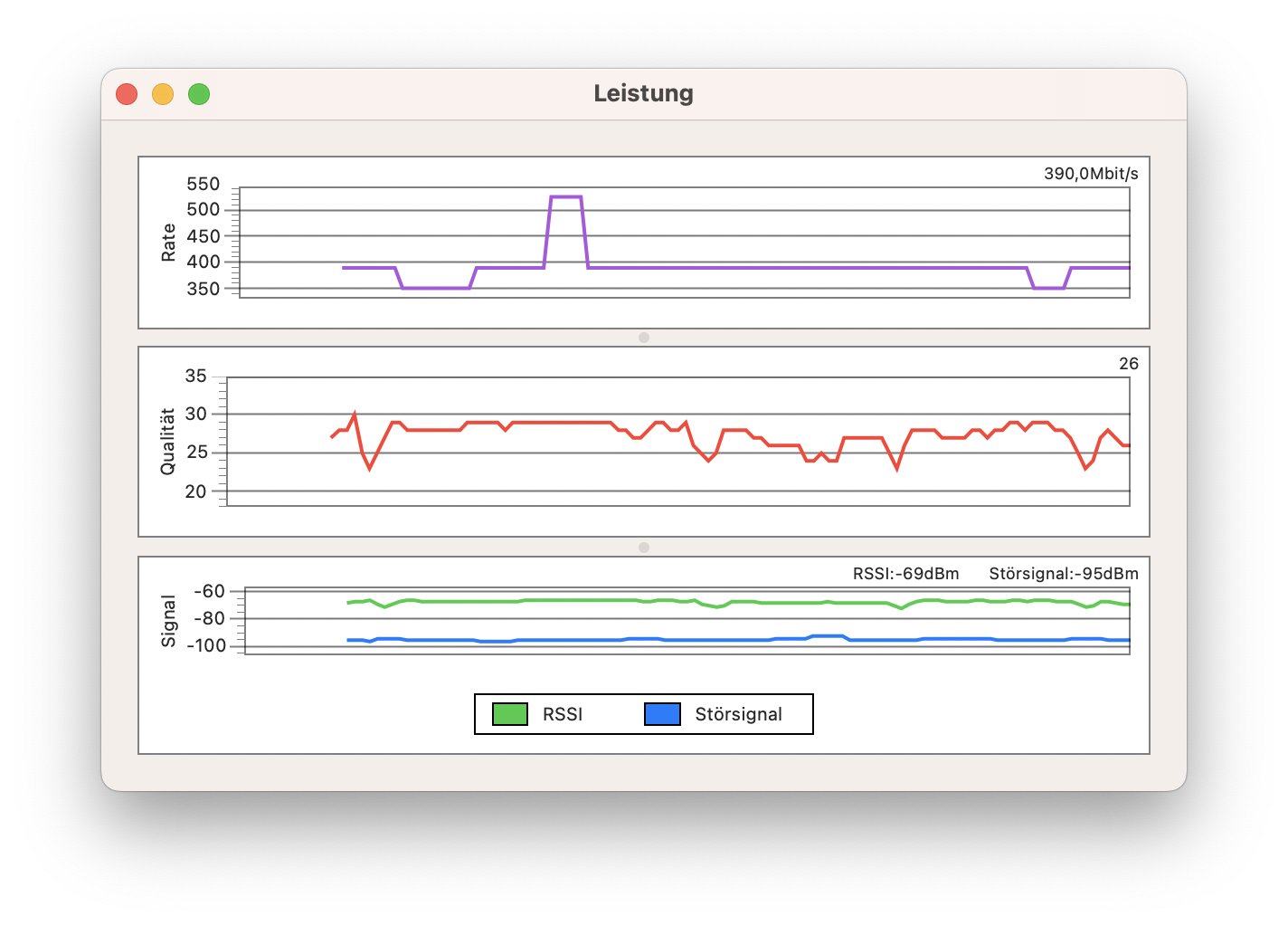

And this is the 16" MBP 2019:
As you can see the MBP 2019 has a tx rate that ranges between 350 and 530 Mbit/s while the MBP 2023 only has 30 - 250 Mbit/s roundabout. The main difference seems to be the noise on both machines (in German "Störsignal"). The signal strength is nearly equal for both but the noise on the MBP 2019 is around -95 dBm while the noise on the MBP 2023 is around -82 dBm.
I have simply no clue what is going on here. Could the higher noise on the MBP 2023 be a specific hardware problem of my machine (which I hope it is not)? Or is this a common finding because of the different hardware architecture of both machines.
