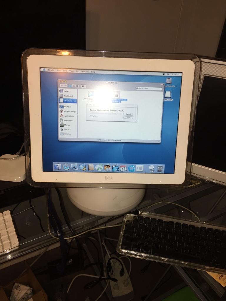

Finally was able to get play with my iMac G4. This is what I am getting on the screen. It boots up to the apple logo but then after a few seconds this appears. Figured its a bad hard drive or could it be something else?

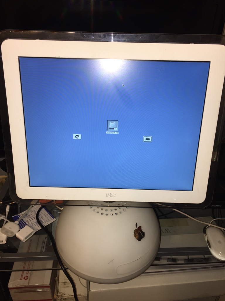

Ok it boots up to the gray screen looking for a bootable drive then after a little bit of time the apple logo comes up. Gets the spinning wheel and then it comes up and freezes the whole screen and then after a few seconds starts with the spinning wheel again
If it does not appear in the boot selector then you cannot rule out GPU failure. If it does appear you know you have a GPU issue. I would throw a new drive in there or even try reloading OS X from scratch and freshly format the drive. Be sure to verify its integrity after install.

I was finally able to reinstall os x on the hard drive and everything seems to be working fine. Now has a fresh install of OS X 10.3 (wish I had 10.4 install disks). I will keep an eye on it and see if the GPU does end up going bad on me.
