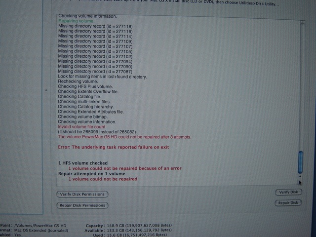

Seems that my G5's hard drive is toast 😡 . It is a Maxtor 160 Gb. I am looking at getting a Seagate one to replace it. Considering I have 3 of them already I think it would be a good choice.
Are there any other brands I should consider?
aussie_geek
ps -see the attached photo of disk utility's conclusion about the drive!!

Are you certain the drive is bad? Strangely, the same thing happened to one of my storage drives. I ran repair in Disk Utility a couple times but that failed to fix it. Then, for whatever reason I tried clicking the other "name" for the drive and ran repair. Amazingly it worked. Possibly coincidence but probably worth the small effort.

Yeah - I am trying a wipe free space at the moment - it is nearly finished doing that.
My plan is to throw Tiger on it and copy some files onto it, fill the drive up, trash them and then copy them again and trash them a few times 😉. This should work the drive I suppose and test if it stuffs up again 😕. I will keep you posted.

I've only had it for just on 2 weeks - it's one of the old 2.5's I got on sale. I had an inkling that it was going down hill when I came home from work the other day. I had logged out after the previous night's session and when I attempted to log back in the following afternoon, it hanged. After a manual power button shutdown and a paperclip assisted insertion of the Tiger CD, I ran disk utility and it found fatal errors so I re-formatted and installed Tiger. It was OK until this afternoon when I got the BBOD.
I gave up waiting for the system to respond after 5 minutes so I just powered off. I tried to reboot and it wouldn't.
Using the trusty old paper clip 😉 I inserted the Tiger install disk and ran disk utility. The results of the test are in my first post.
I will be calling the store I bought it from tomorrow. Now here comes the complicated bit... I bought the G5 from a department store that I know will say 'contact Apple regarding warranty claims'. I will insist on getting a new one, but considering they only had 3 of them left at the price I paid, the chances of being 1 left for exchange is slim - even if they agree to exchange is another thing...
I know Apple will exchange the drive for a new one but I just can't do without this G5 at the moment. I think I should just bite the bullet and get another drive and then talk to Apple later about getting a replacement for the dead one. Lets hope Apple doesn't require the G5 to be sent to them just for a HD replacement. Maybe they can just send one out to me....

First of a way to check if is the drive. Go into disk utility and click the top level drive. Look at the bottom where is says the stats. Look at S.M.A.R.T status, does it say Verified? if so i don't think it you drive. This is the thing on the drive that tell if it is dying.

The SMART status failed on the disk utility check I did before the last wipe of the hard drive. Seeing this has happened, I am inclined to buy a new HD. I have found a good deal on a 250 gig Western Digital so I might go with that one.
