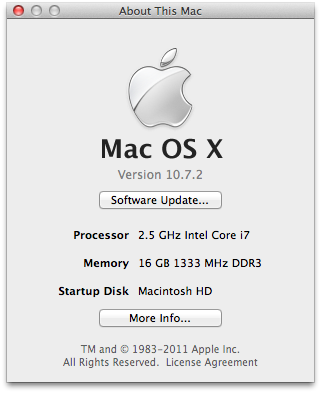

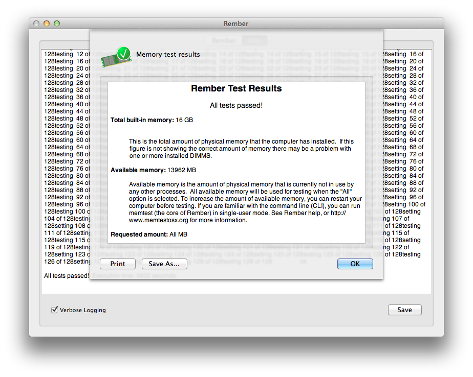

So the machine ran fine yesterday on my stock 4GB of RAM. I decided to put the 16GB RAM back into the machine last night just for kicks. So far, everything has been running OK. I tried multiple CPU stress and browser tab tests last night, and I experienced no crashing or freezing of any kind. I also ran 1 round of Memtest on each individual DIMM, and no errors were returned.
I put both DIMM's back into the MBP and ran 10 rounds of Memtest overnight on all 16GB. I had to cancel the test when it was time to leave for work, but at that point I had completed 7 rounds. Therefore, I'm pretty sure the RAM modules themselves are OK, based off Memtest runs.
I also blew some air onto the RAM slots when I took the 4GB out, and onto the 8GB DIMM's. Now I'm wondering if either A) I seated the RAM incorrectly or B) A small piece of lint got in the way of the RAM contact patch, allowing part of the memory to not be properly addressed.
The system recognized all 16GB previously, but perhaps one of the DIMM's was loose. Since I was using the laptop in my lap, maybe sudden movement caused the DIMM's to move slightly, causing my instability/freezes. As stupid as this sounds, I'm actually hoping this is the issue, because I'd really like to keep this RAM and SSD.
For kicks, I ran yet another memory test once I got to work this morning. This time I tried using Rember, which I'm pretty sure uses Memtest as a back-end app. This also passed, screen shots below.

  Walking Ones        :    ok
  Walking Zeroes      :    ok
*** Memory Test Failed ***  Please check logfile for details.
Execution time: 13188 seconds.
